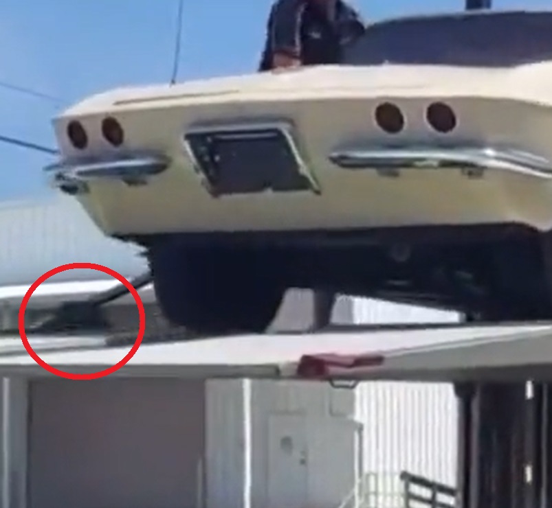

    The chock was a small one . . . and only one!

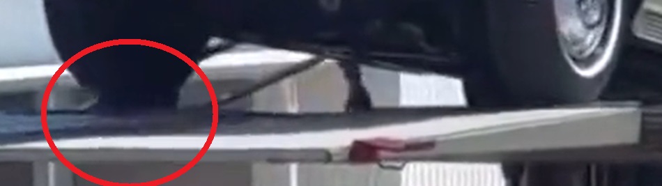

    Notice how the tire is elevated here (on top of the chock) and the right side is flat on the deck.

    His problems started when he let that 3000 plus pound puppy get rolling that quickly while on the outside of the car....it's all down hill from there...

    I think that was the internal rail transition to the ramp on the back, not a chock
    Listen to what the operator says at the twenty second mark "it rolled right over the fu2k!ng chock block!".

    I understand that the non-block was identified as a chock block, but just because he says it is a chock block, that does not make it a chock block - just saying...

    I am sure many of you already know all of this, but it has to be said.
    There are lots of ways to use equipment improperly. Sometimes, there is more than one way to use equipment correctly.
    It is clear, whatever equipment on hand on that day, it was being used incorrectly. Perhaps they had gotten away with being stupid on previous deliveries. On this day, the odds caught up with them.
    A rig like SHOULD have a winch in front to pull the car into position. That which SHOULD have been used in reverse to allow the car to back out under total control while still connected to the winch. When the car was in place on the elevator, the chock should have been set it place. Then brake in the car set and the transmission put into park or a low gear. ONLY THEN should the winch cable be disconnected.
    Chocks are not meant to stop a rolling vehicle, they are meant to keep one already stopped from rolling away.
