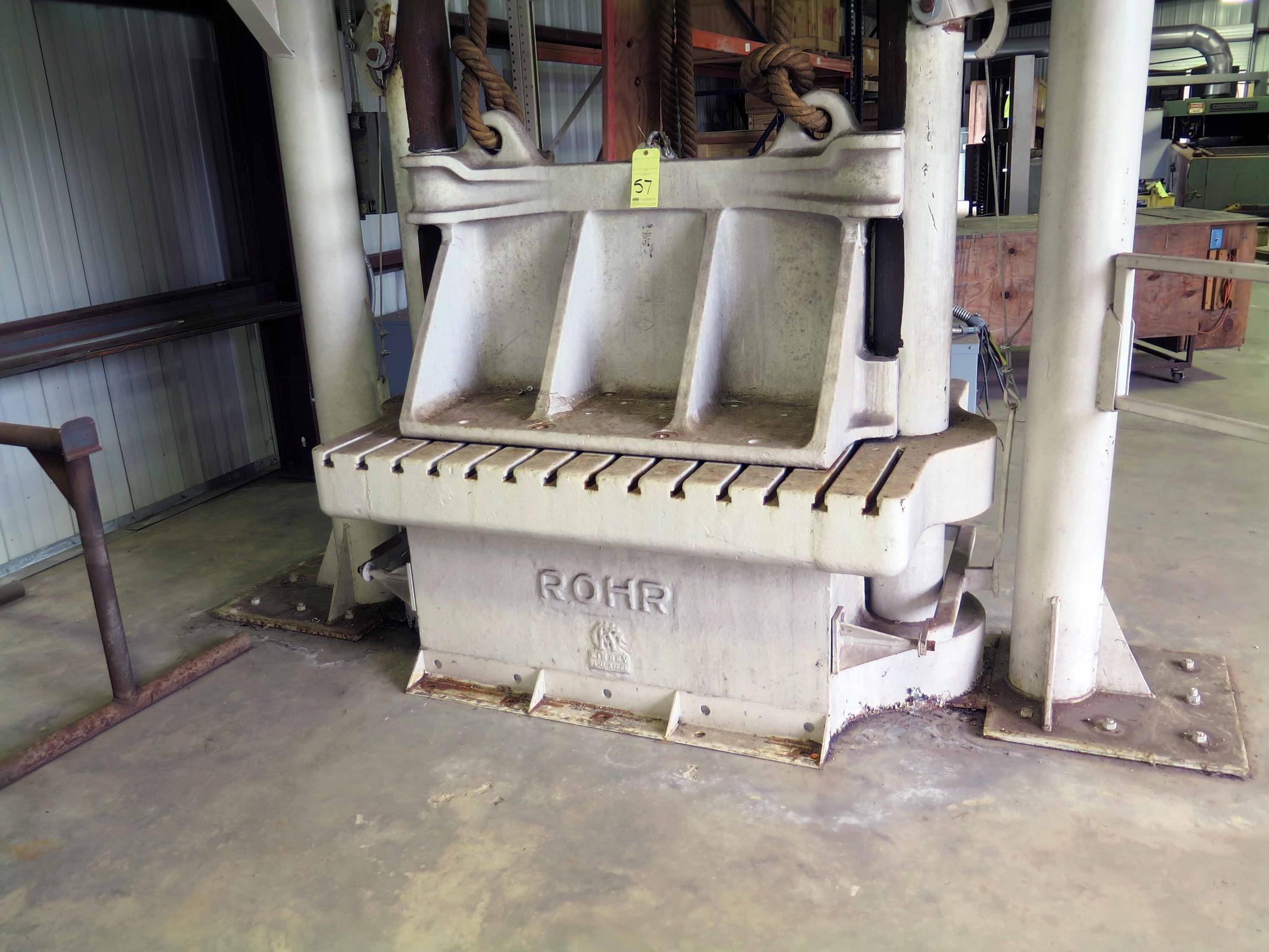

    So, what are we looking at here? I understand the drop-hammer forming die set-up
    but what is the purpose of the long lengths of rope?

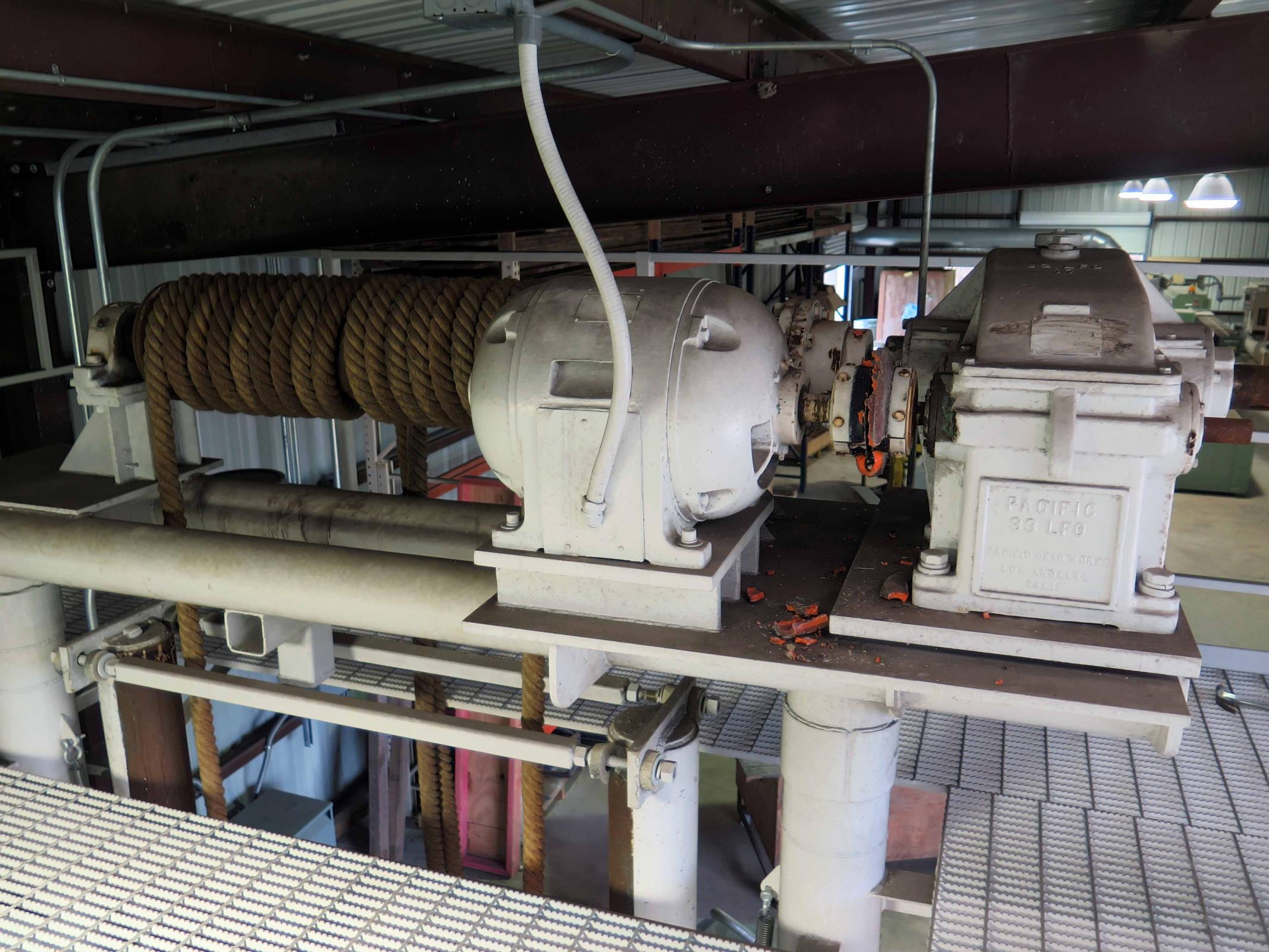

    The ropes are part of two windlasses (I'm assuming), which are your basic gear reduction mechanisms for lifting the heavy weight. I'm not sure just how the mechanism releases to drop the hammer, but I believe there's a point at which the shaft(s) on which the rope is wound freewheel, thus dropping the hammer. Why there's so much rope used in this application is a mystery to me, as a typical windlass doesn't need that much rope.
    Here's an example of a motorized drop hammer along with a photo of the electric motor, gear reduction and rope drum (notice how comparatively little rope is used in this application vs. the above photo):

    The ropes dont appear to be wound tightly enough to indicate that they were used to raise the weight. Also the coils appear loose enough that if they were allowed to free spool at acceleration velocity they would certainly overrun and tangle. But I couldnt google up any vids of one in operation. So I dont know either?
