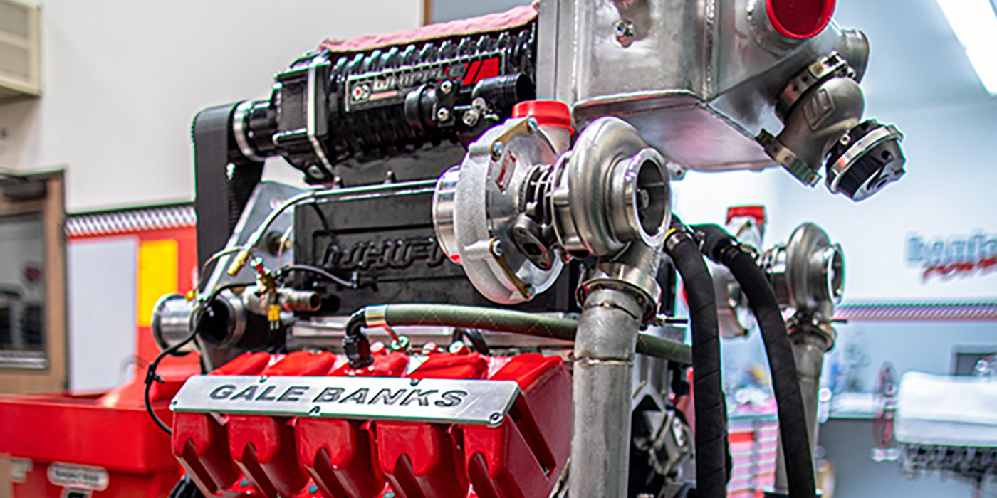

    Turbo fed supercharger with two intercoolers...
    1927 Ford Model T Double-Trouble - video-twin-turbo-7l-duramax-banks-power-feature.jpeg
