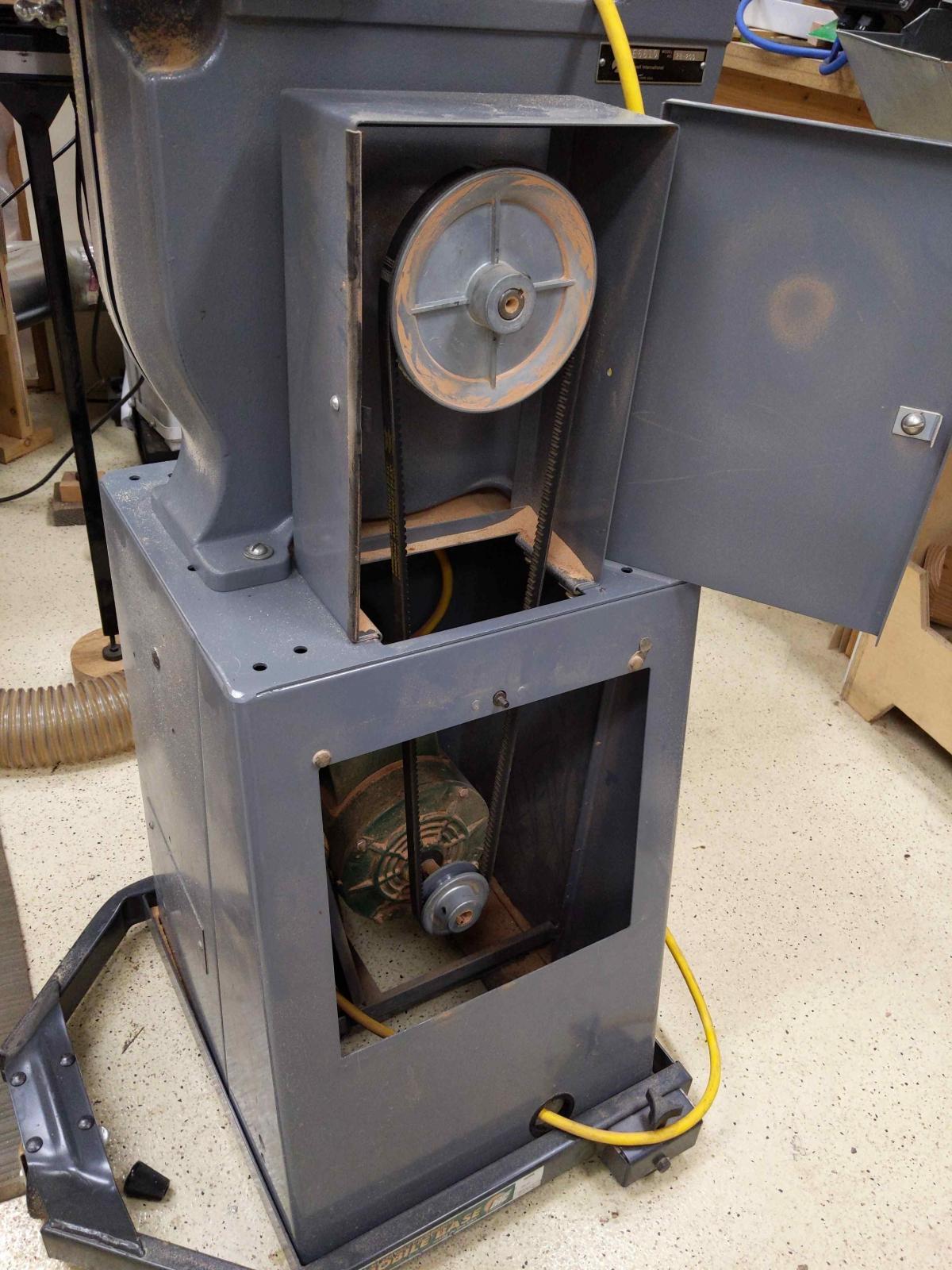

    I believe that I have the original Rockwell version of your same bandsaw, also with the 6" riser. I concur that the supplied 3/4 HP motor was too anemic for serious resaw work, and years ago I upgraded mine to 1-1/2 HP. I am quite satisfied with the upgrade. Here is a pic of the driving end of my bandsaw - if yours is similar than I think the job will be very easy for you: (click the pics for full size)

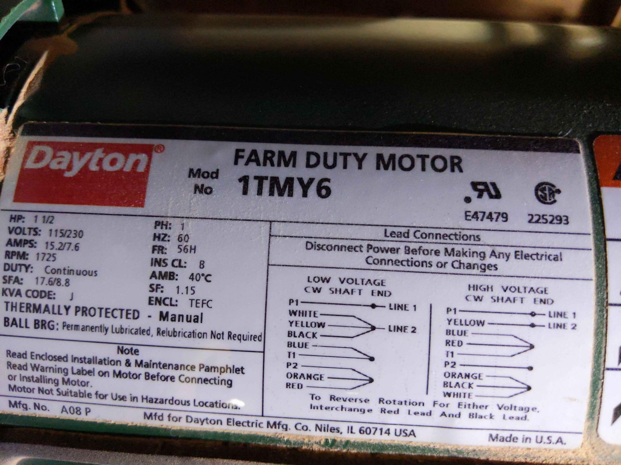

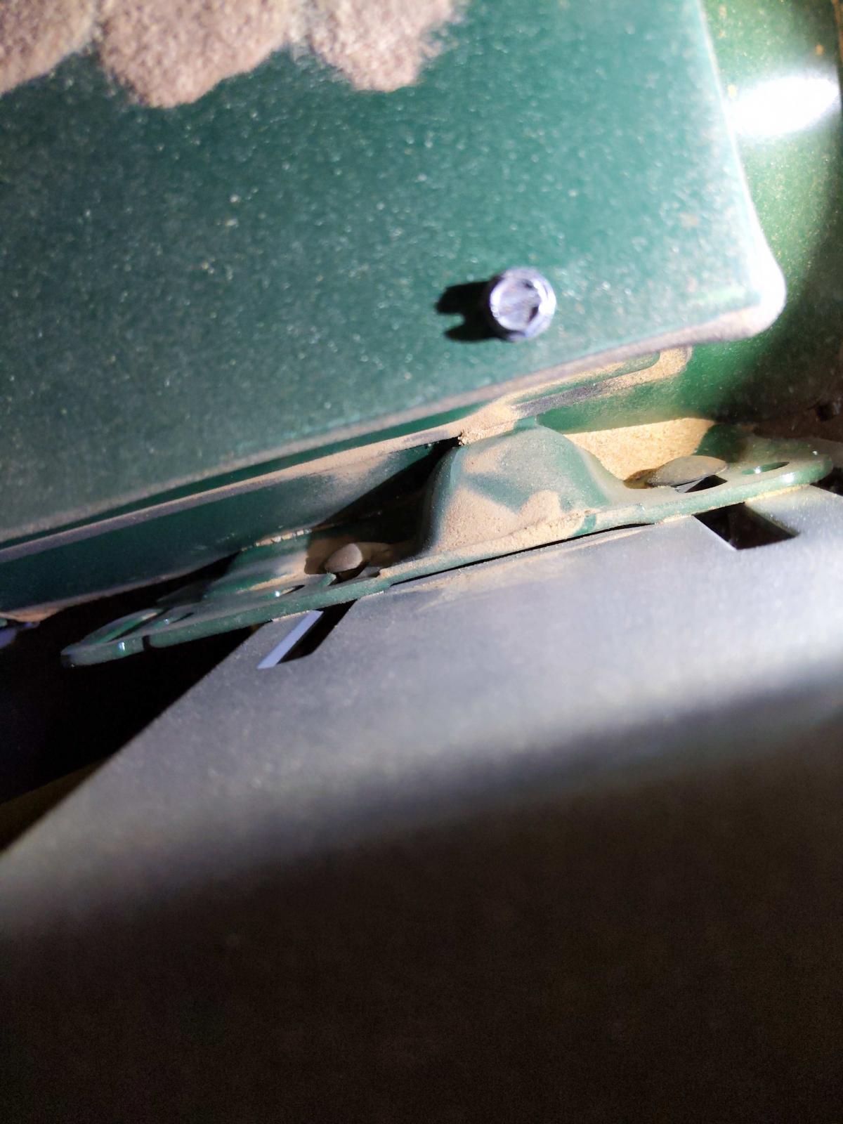

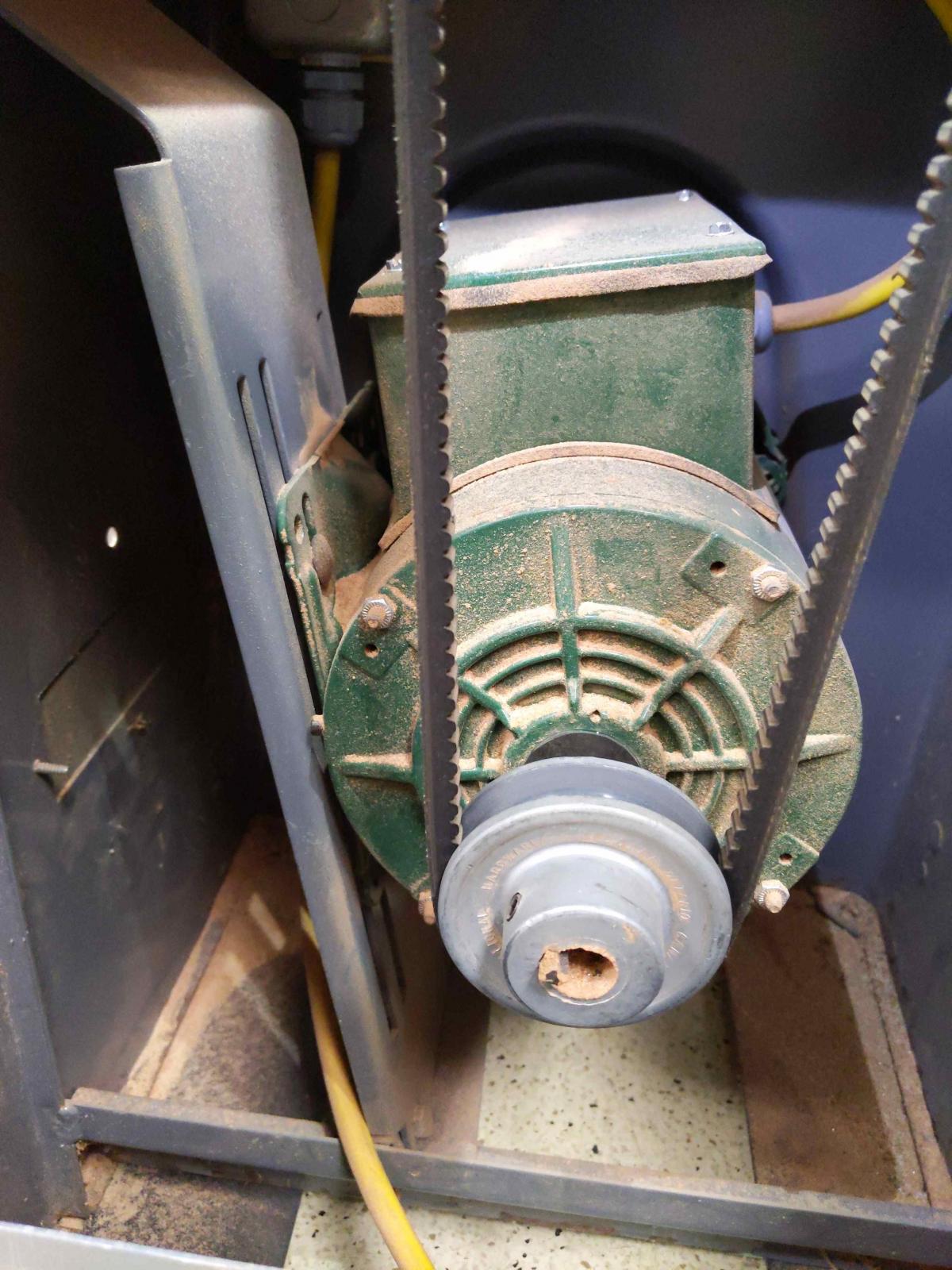

    A couple more pics showing the motor mounting plate with multiple mounting slots, and the data plate of the motor I used, a '56H' frame size that I purchased at Grainger. The important things, as Charles mentioned, are the correct RPM (1700-1800), motor shaft size (so you can reuse the same pulley), and wire gauge. I wired my replacement motor to run on 230V, the original was 115V so even though I doubled the HP, the amp draw is approximately the same, so the same switch was reused.

    One important motor consideration I forgot to mention - it really needs to be a TEFC (Totally Enclosed Fan Cooled) motor....as you can clearly see in the pics, it gets dusty down there and you don't want that inside the motor housing!
