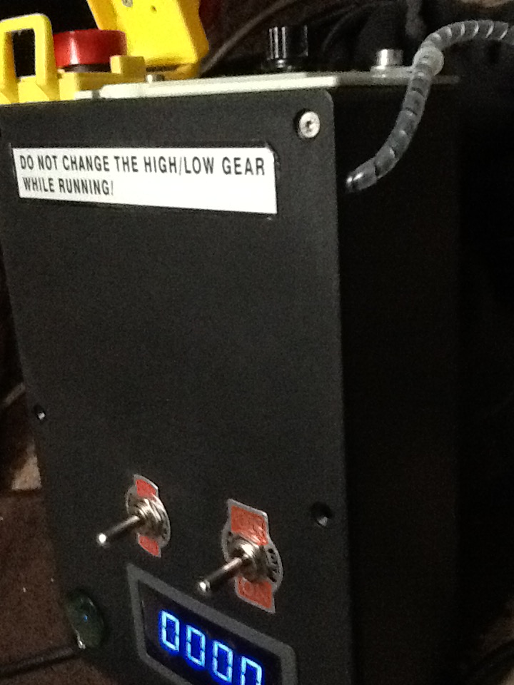

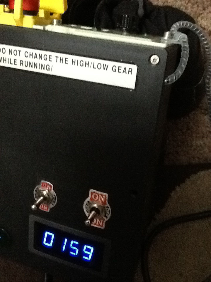

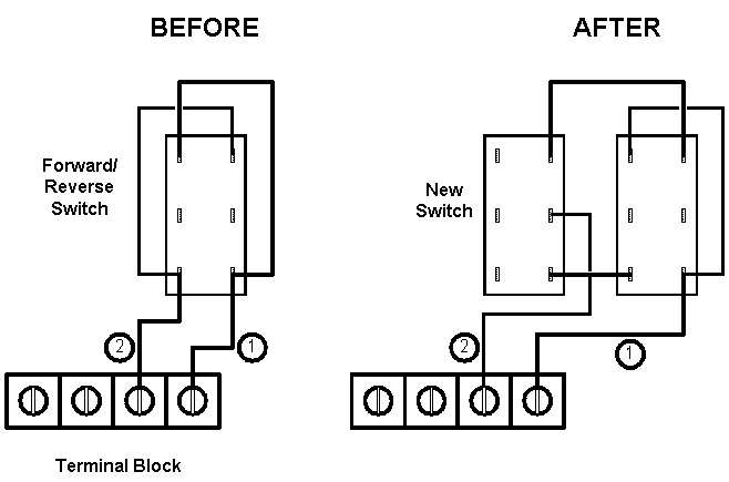

    Been kind of busy this week working on the mini Lathe controller box. I hated the side mounted speed control the fact it had NO tacho and you could wreck the gear box with a clumsy move of a single switch.
    The power cable was permanent wire in so used a kettle lead skt with built fuse holder, the knock /lock out I kept the speed controller is on top the box now contains a 12 volt supply for cooling fans and the Tacho which only run when the chuck runs. forward / reverse can only be activate with both toggle switched in synch. cost total about 30 ukp plus my time.12” x 37” Lathe Tailstock Clamp Improvement-forward_reverse_interlock-b4.jpg12” x 37” Lathe Tailstock Clamp Improvement-lathe-tacho-working.jpg

    much better with 2 switches

    yes the double switch stops the accidental stripping of the gear box

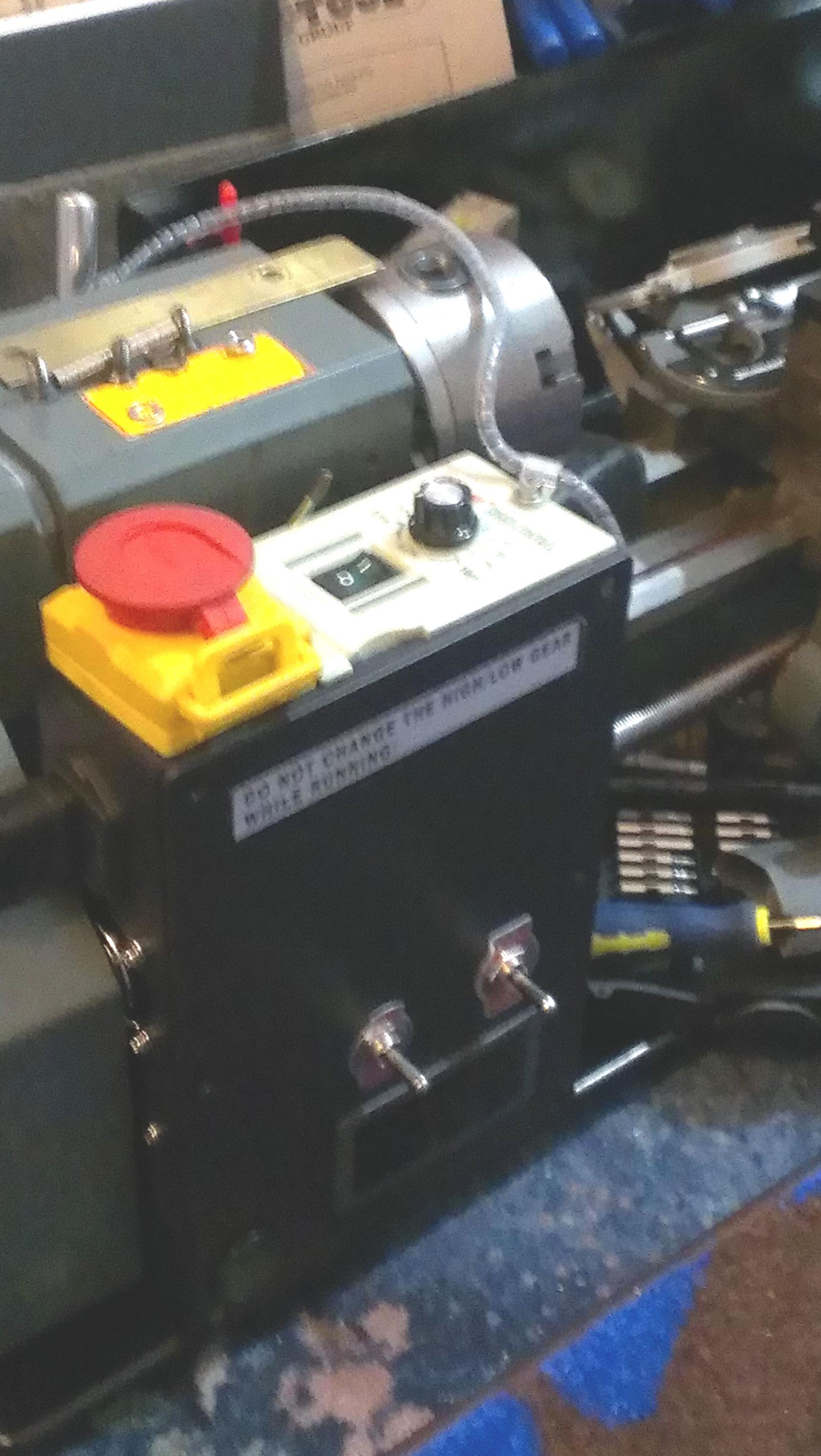

    This is the new control box (the original had the speed control on the side and NO Tacho )
    the power is thro a computer "kettle " lead, retained the original lockout/emergency switch,speed control & on/off now on top for easier setting, inlet fan for electronics cooling, double switch as discussed, Tacho read out (the flying lead is the sensor ) and an exhaust fan in the base for air movement.
    What you do not see is a PCB from a "wall wart " inside the box that is 240V from lockout switch to supply 12V to the Tacho & two fans quite a lot for a box that is only 221mm x 150mm x 60mm. the down side is i had to remove 20mm from the gear box cover edge closest to the controls.

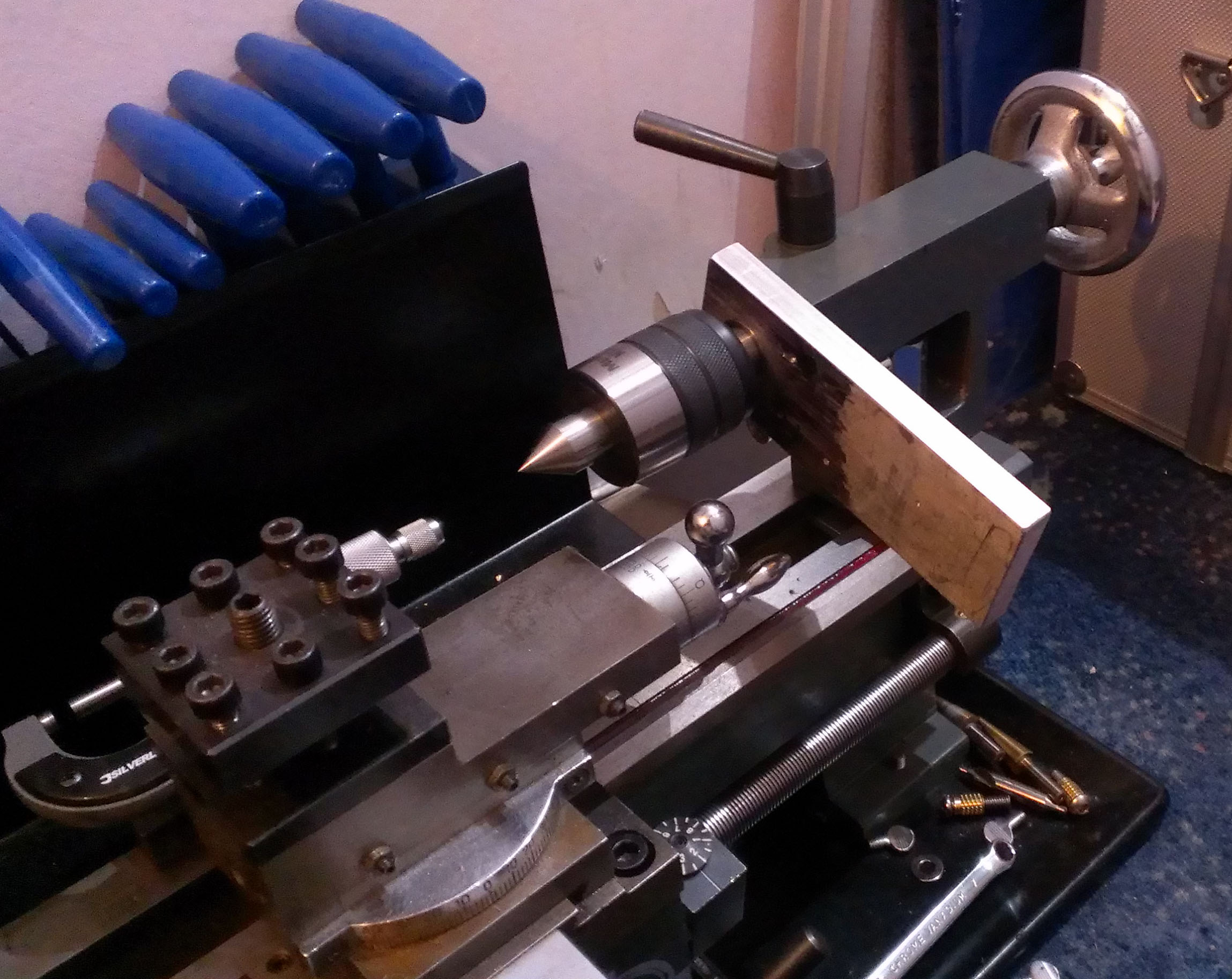

    Made a start on the tail stock DRO set up
    12” x 37” Lathe Tailstock Clamp Improvement-tailstock-dro%3Dclamp%3Dstart.jpg

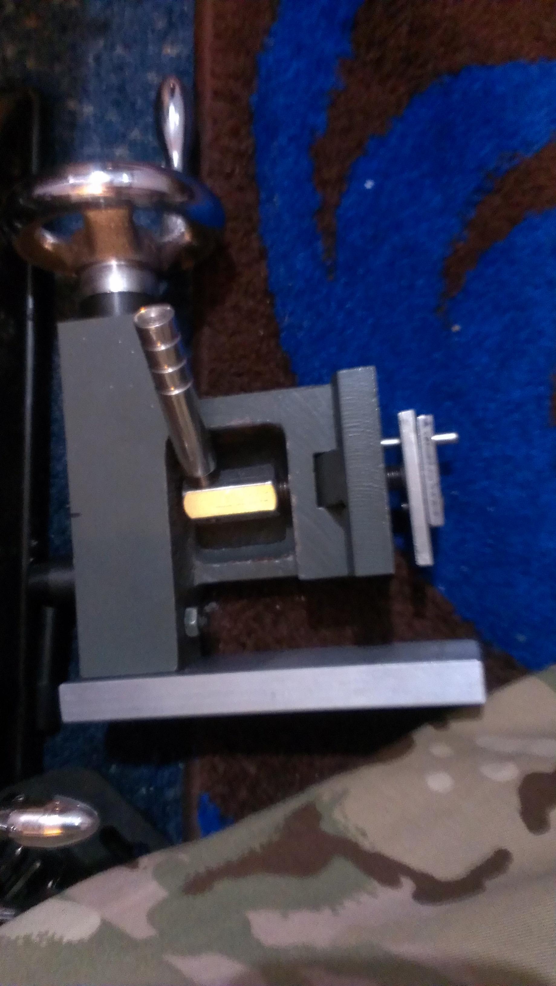

    and replaced the original clamp foot again (wider than original and alloy for more bite )
    replaced the locking clamp nut with a hex studding connector (shortened by 10 mm ) with tapped holes for the handle on alternate faces

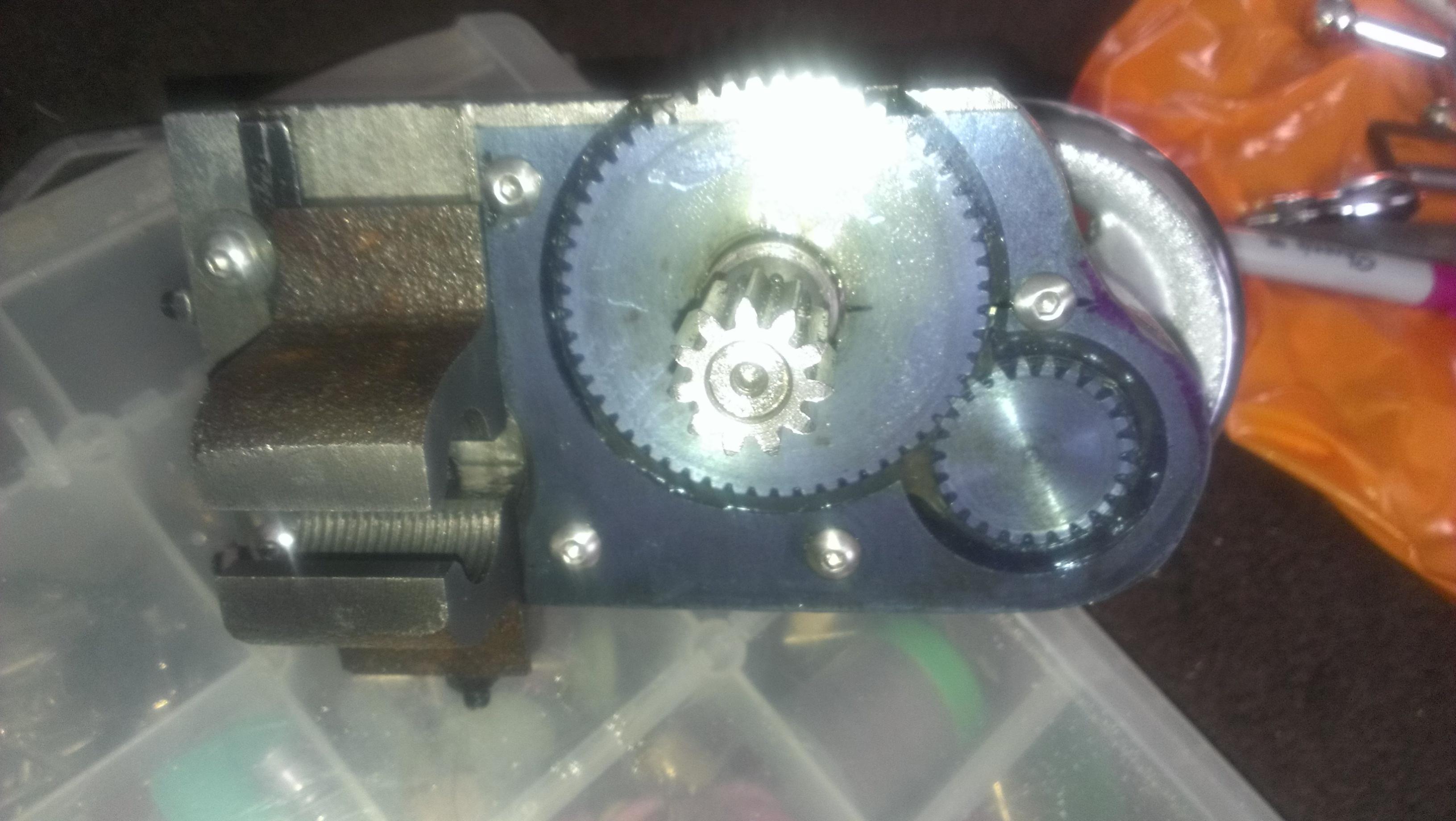

    also took off the saddle gears for cleaning
    and added a swarf barrier made of perspex to keep the crud out

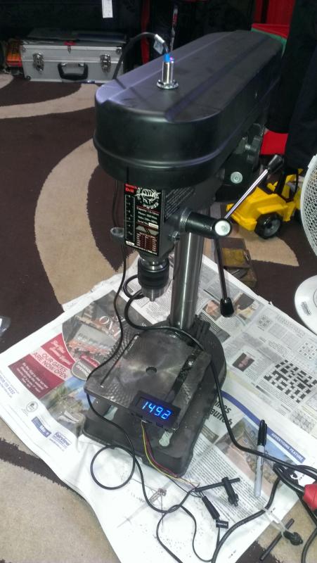

    when i got tired of working on the lathe i modified my drill press and fitted a tacho since the RPM is about 50 -300 revs out in reality depending on what pulley pair is in use
    the sensor now holds the read out box and again a wall wart PCB supply wired to the motor cct so it only on when quill is spinning. nice and neat on the top of the pulley guard

    There is now a magnet glued to the top pulley of the quill stack on the drill and in the castle ring nut groove in the headstock shaft on the lathe, the sensor is a 12mm diam X 40mm long that houses a reed valve i believe, that pulse is counted by a tiny pcb behind the read out Led screen. I have now three i bought from 2 vendors (all chinese) the problem is one came with Kanji instructions so i went to our chinese take away to get it translated.Technical chinese characters are not well known by the average chinese but at least they could read the colour code and i worked it back from that.
    Word of warning IF THE POLARITY of the magnet is wrong IT WILL NOT WORK , do not ask how i know lolz
