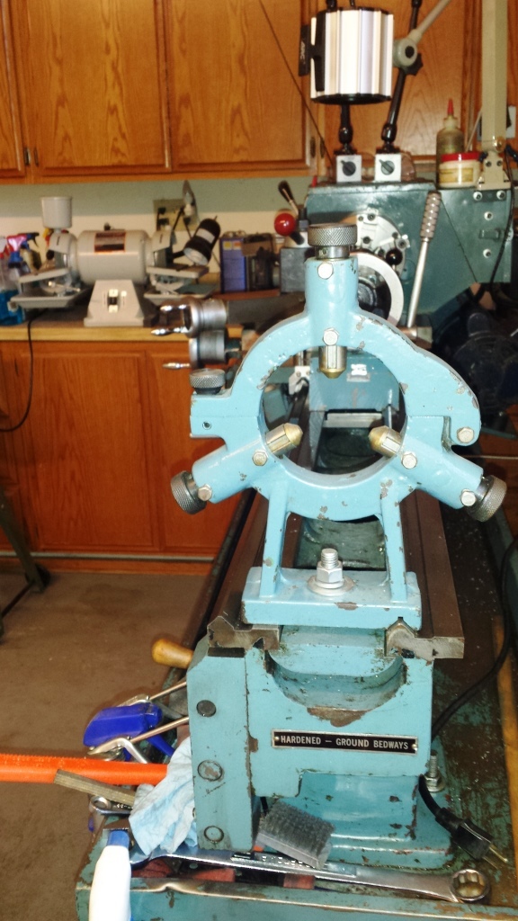

    Everyone,
    Just in case you had this question. I re-used the original bottom locking plate from the tailstock on the original center rest for the lathe. My used lathe included many accessories but the original center rest was missing its bottom locking plate. The original bottom part from the tailstock fit perfectly on the center rest and no need to make yet another replacement.
    12” x 37” Lathe Tailstock Clamp Improvement-reuse-tailstock-locking-plate-center-rest.jpg
    I want to replace the brass tips on the center rest with small ball bearing rollers. I would like to see if anyone else has examples of this type of center rest modifications for adding ball bearing rollers or know of examples on the Internet.
    Thank you,
    Paul Jones
    Last edited by Paul Jones; Aug 15, 2017 at 09:12 AM. Reason: forgot the attachment
