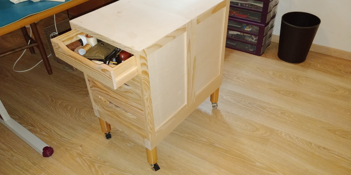

    Hi friends, and happy new year !
    Here is an idea that suddenly came to me, a quick build, very usefull :

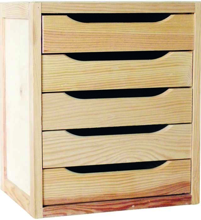

    You take this, purchase two of them :
    Then purchase a set of these : (bed feet)
    and purchase a set of these :
    And eventually, you get to this ! :

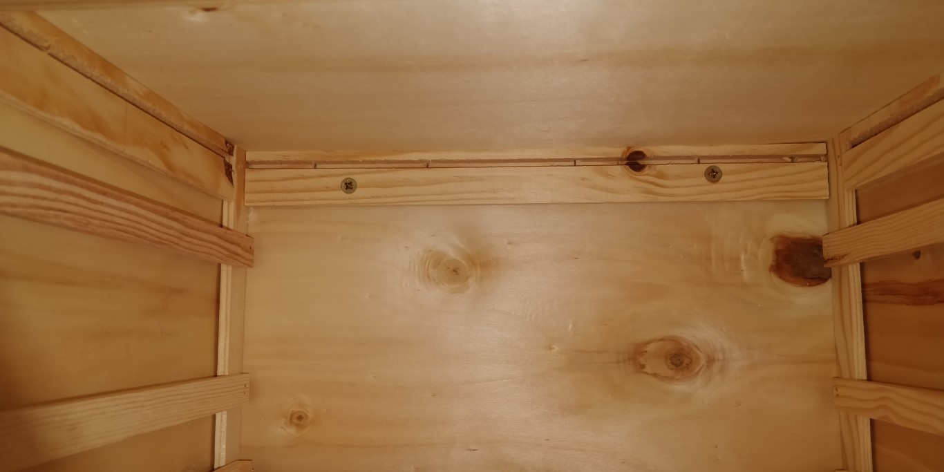

    The drawers blocks are screwed back to back, removing the drawers :

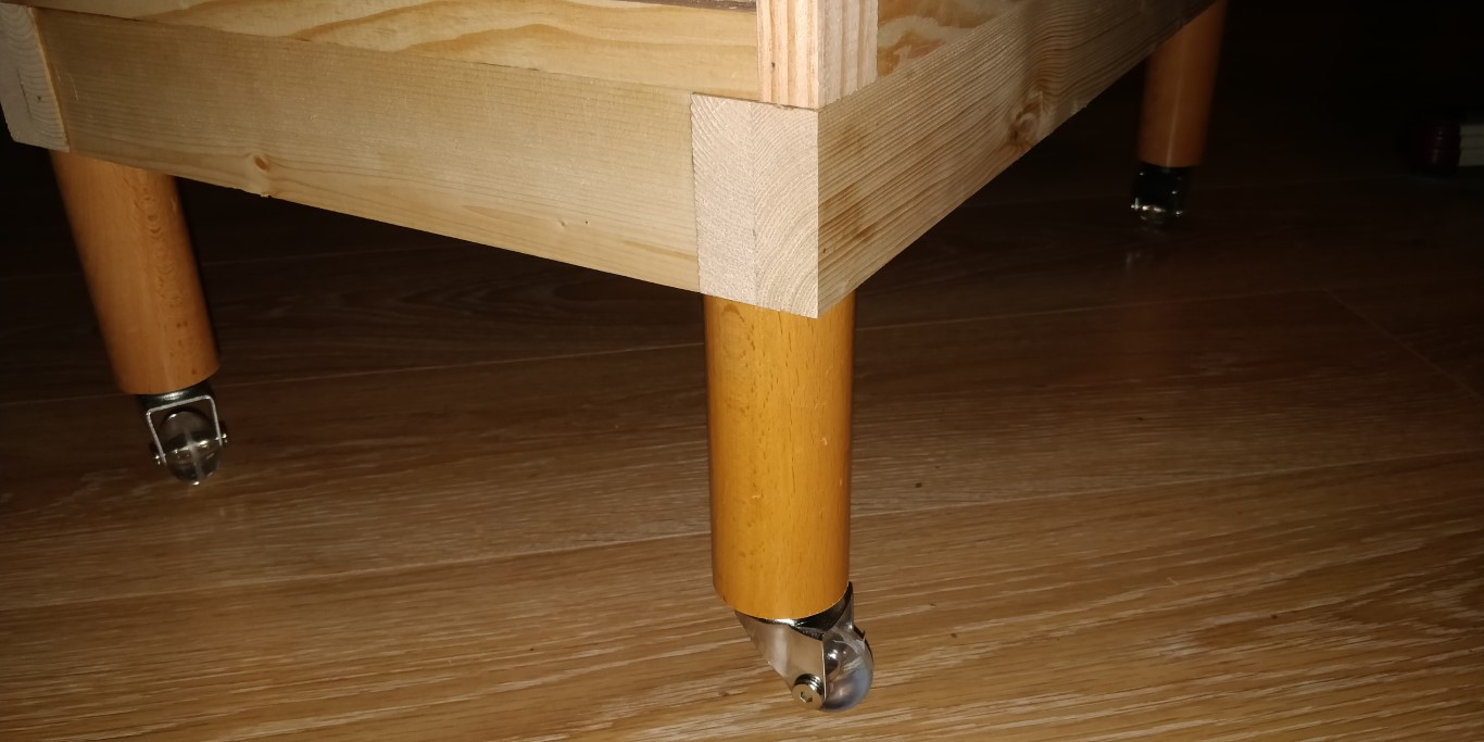

    I added a quickly built square frame at the bottom in order to get a kind of apron, in which I drilled the holes
    for inserting the feet.
    The casters are screwed at the end of the feet.
    and that's it !
    It can be easily rolled under the table when you don't need it. (I shortened the feet for it to fit under my table)
