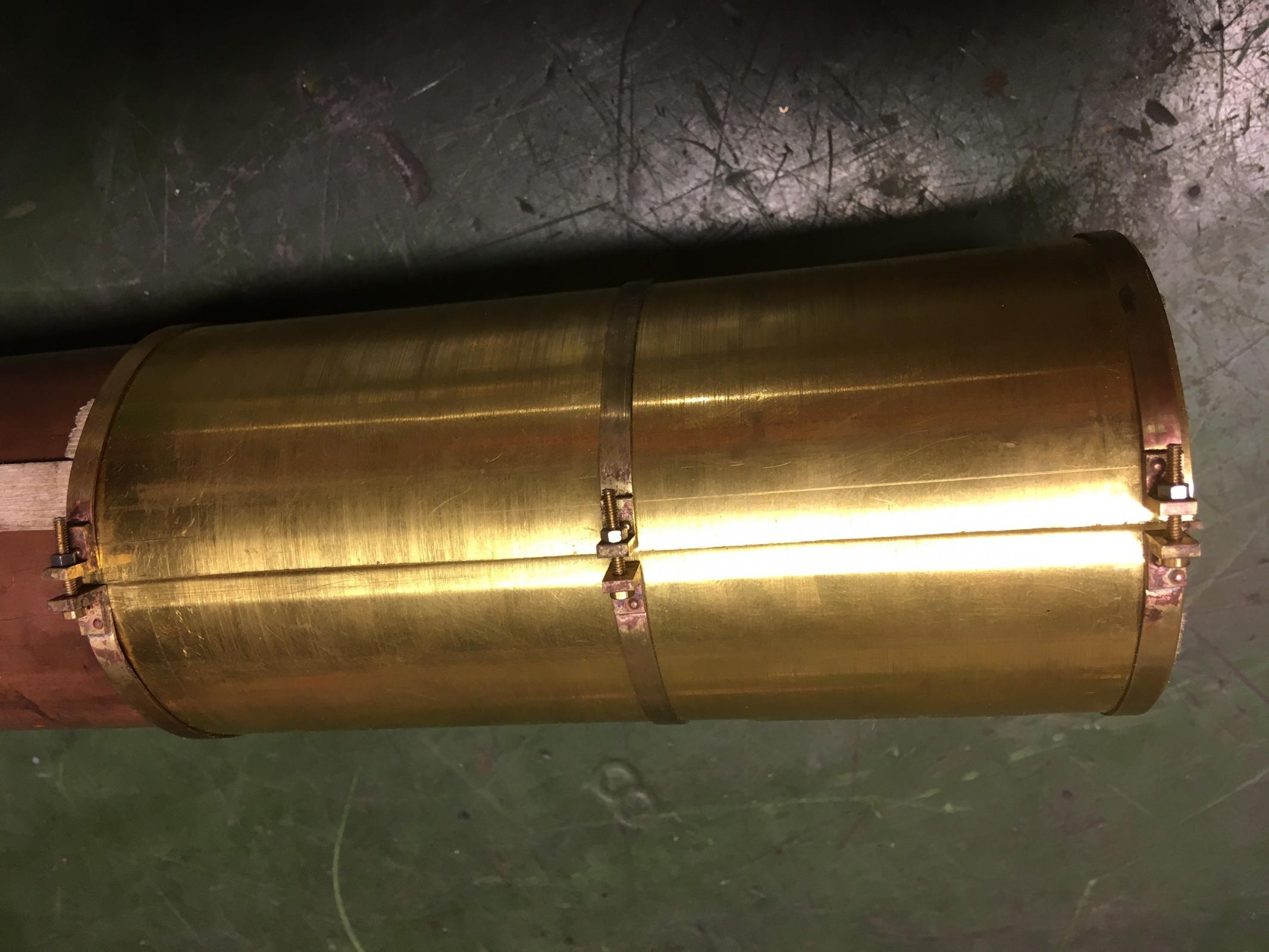

    Over the last few days I have decided to set a new years resolution and finish my 1" scale traction engine which I started in 1985. The engine is almost finished with only a few jobs such as the plumbing, fire grate and coal bunker and a few other minor jobs. It will then be taken apart for painting.
    Over the last few days I have made the boiler cladding and boiler straps. My home made bead roller had a couple of dies made to create a joggle along the edge of the brass cladding to ensure a nice fit.

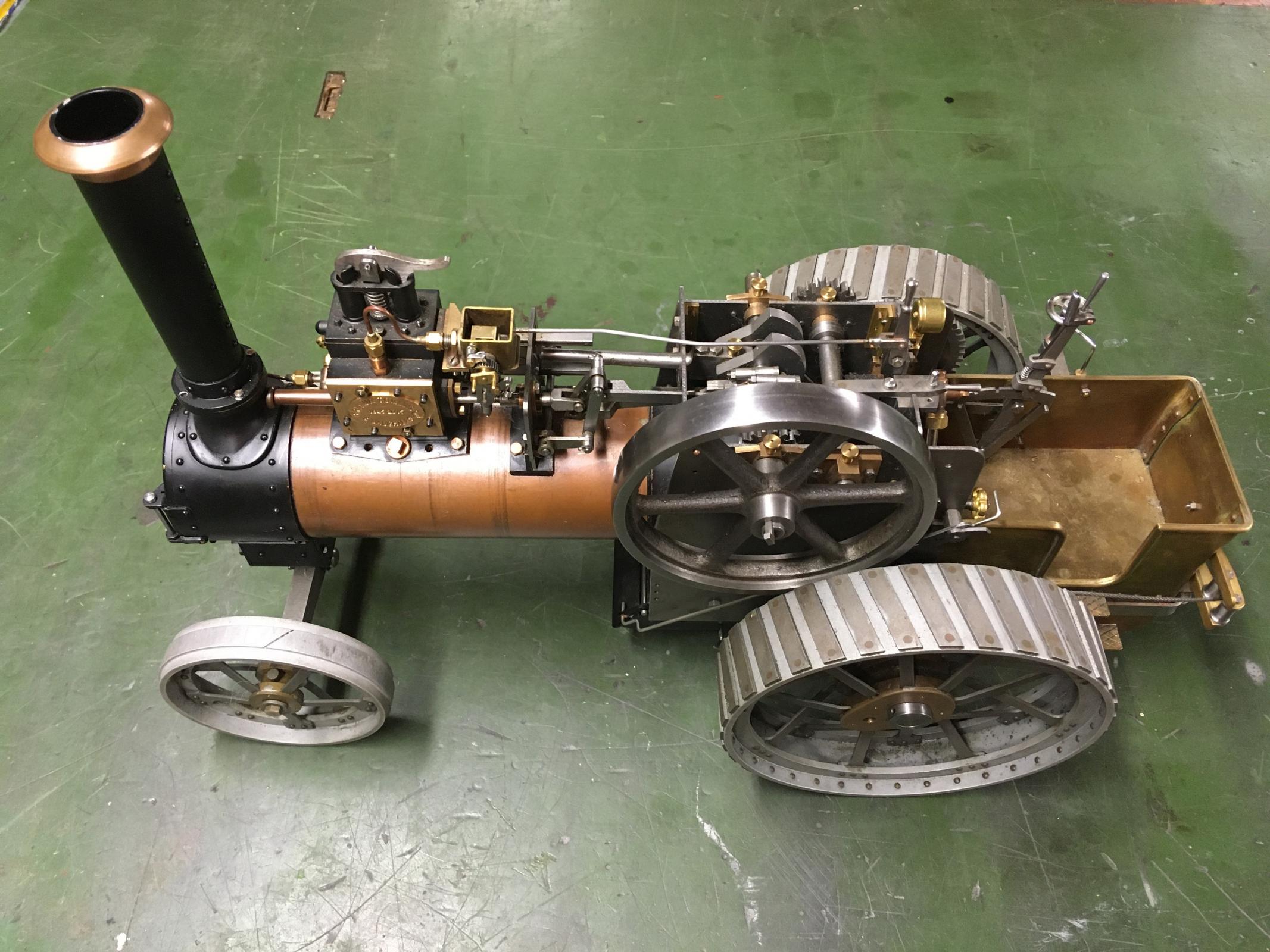

    engine needing a little TLC

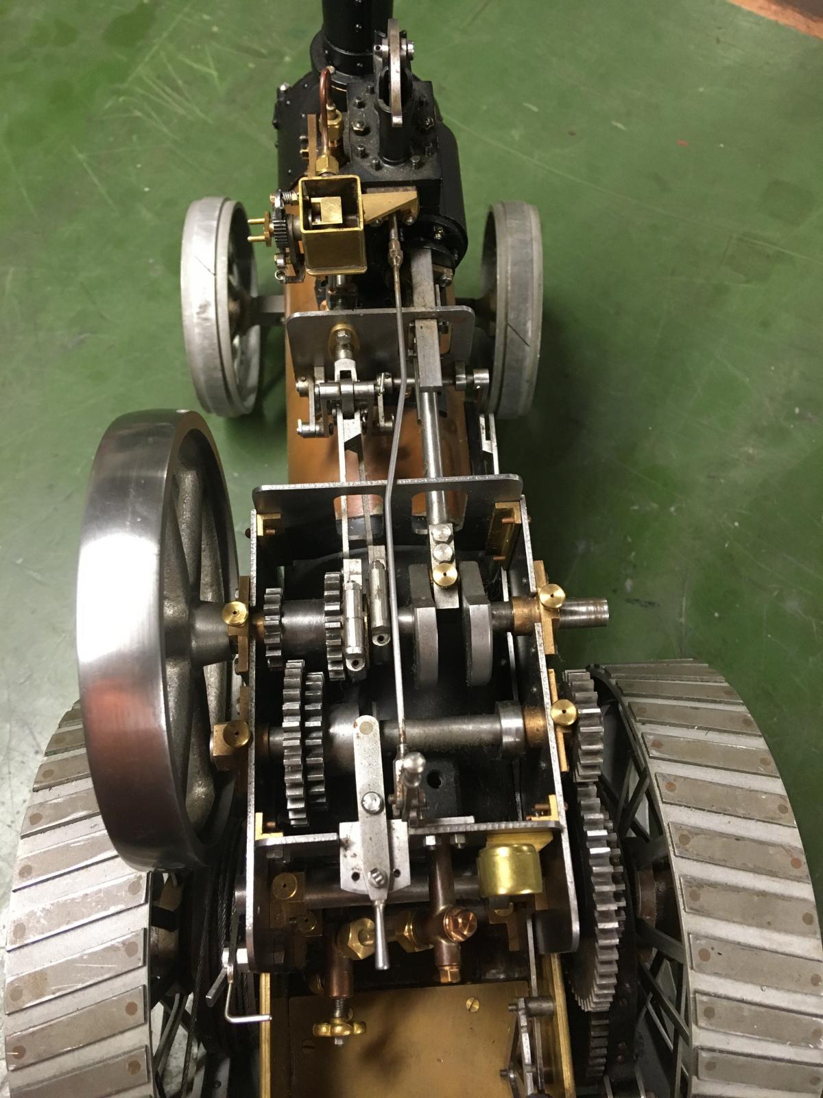

    showing motion gear
    Boiler bands riveted and silver soldered ends. These took an incredible four and a half hours to make

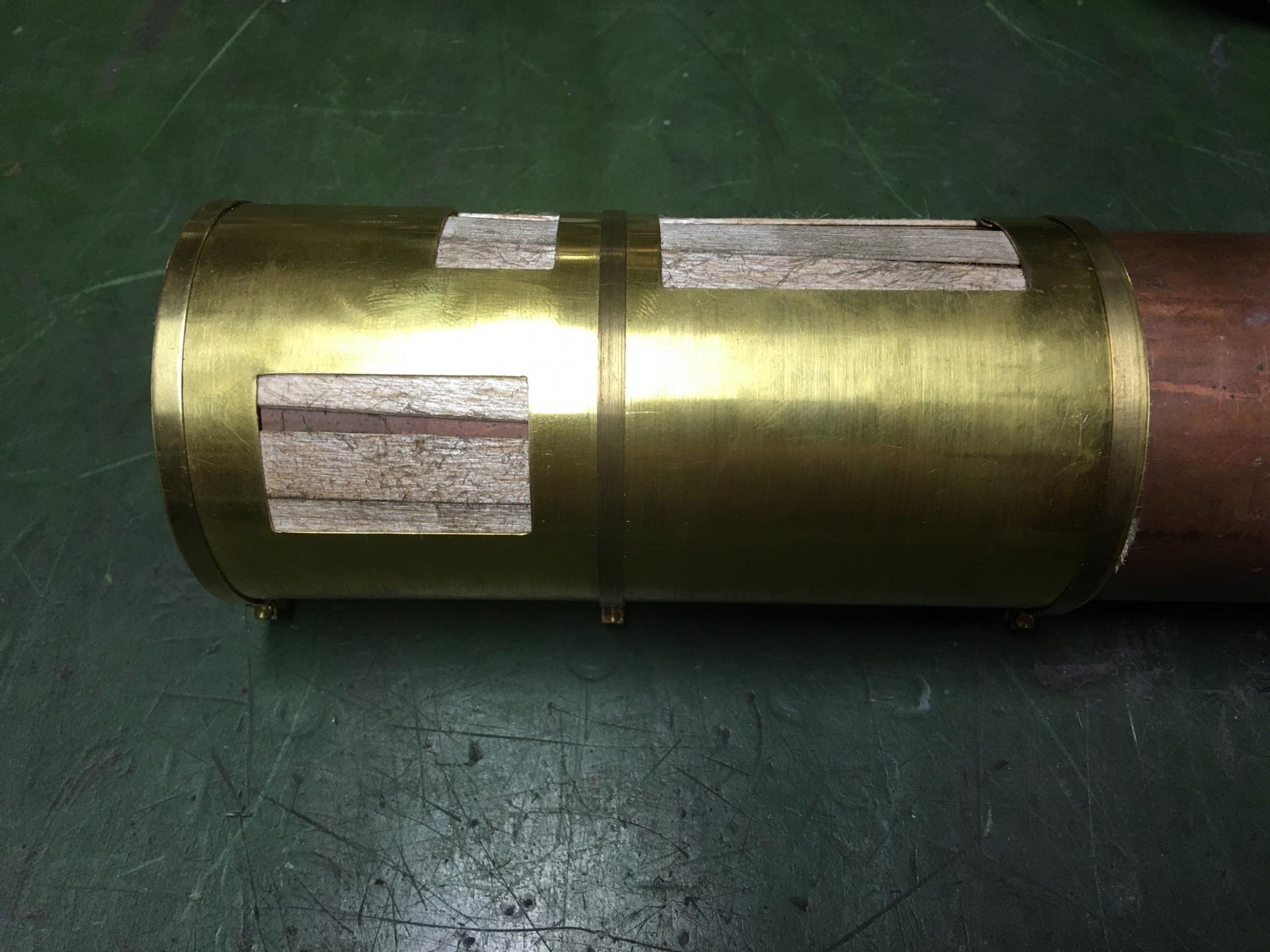

    Cladding with cut outs. I made a cardboard template to ensure the cutouts would fit the boiler. Trial fitted to a 2,5" tube with wooden insulation material to create the correct diameter of boiler.

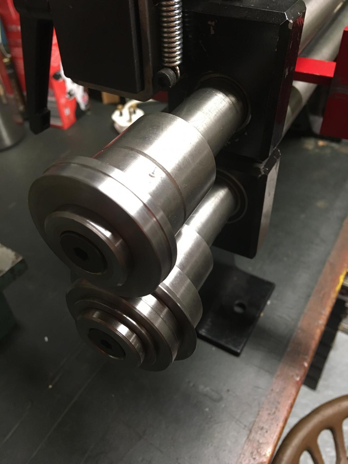

    Joggle dies to 0,5mm set

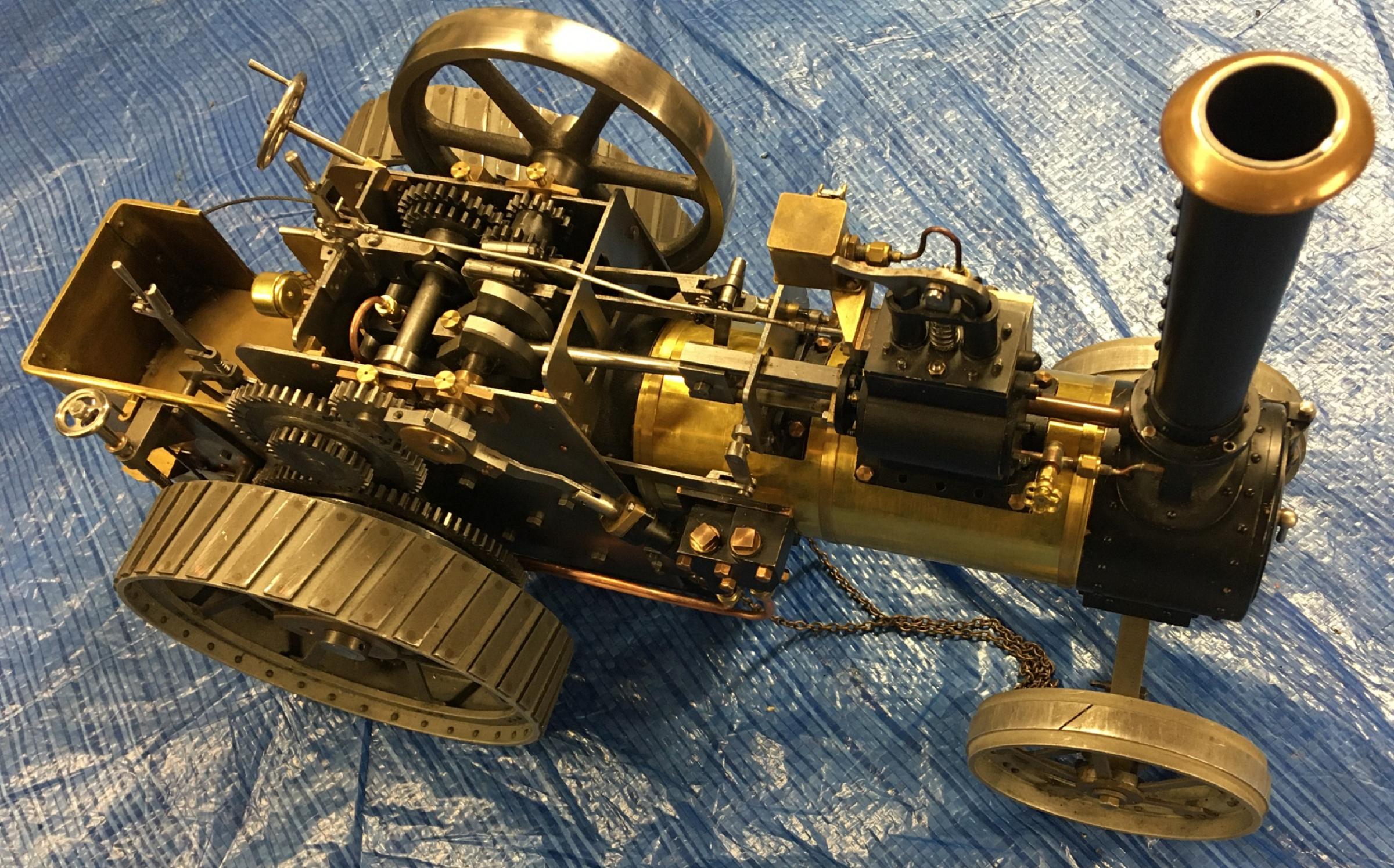

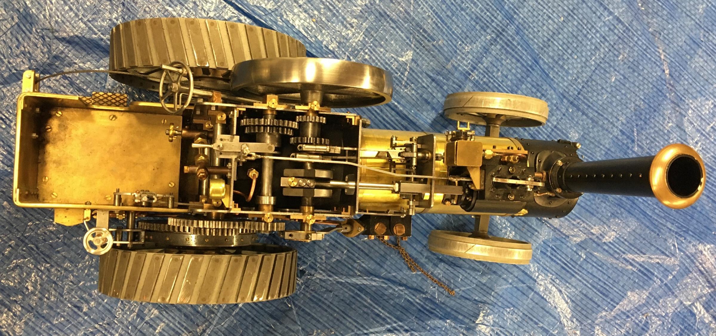

    Some photos added as the engine is nearly completed.
    Jobs left to complete:
    Fire grate (material on order).
    Water gauge blowdown.
    Coal bunker.
    Drilling tender for rear number plate.
    Attach chain to gear selection pin.
    Manifold plug
    Then take apart for painting
    Whistle (got to have a whistle)
