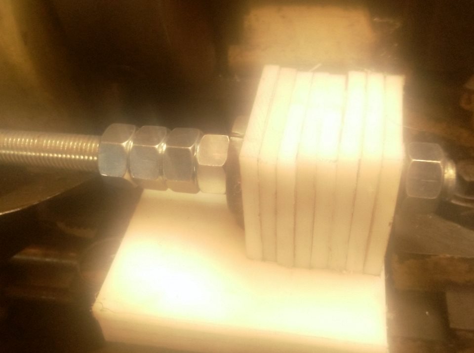

    Sometimes you need an adjustable length arbor but don't need precision.
    What I did was took a 12" long 1" threaded rod spun 3 nuts on it jammed the 3rd and the 2nd to lock it then chucked on #1&2 in my 3 jaw then turned some UHMW disks
