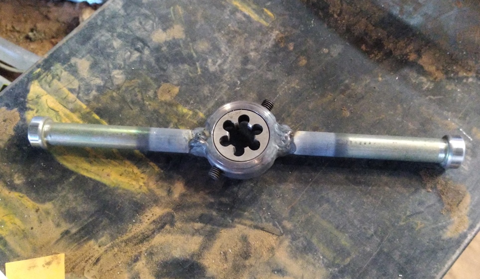

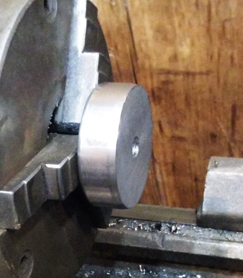

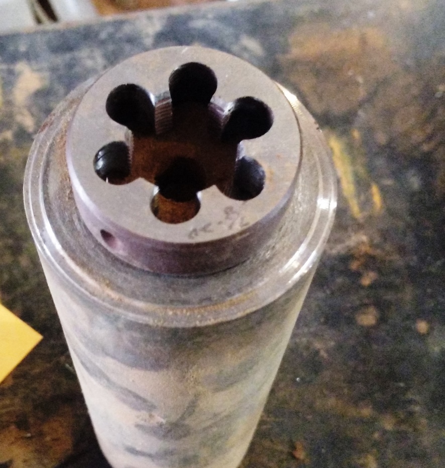

    Even though I do most of my threading by single point, if at all possible I like to have the taps and dies to chase or clean up the threads if needed.
    In the case of having to make special threads such as NEF "national extra fine" like 7/8" 20 TPI and 1" 20 TPi My Greenfield 7 tap handle will hold the taps, but I didn't have a die stock for the 1 7/8" diameter die. I don't have a 1 1/2 a 2" or a 2 1/2 for that matter either and if I don't find a bargain on them, I will make them as needed I prefer Wiley & Russell / greenfield

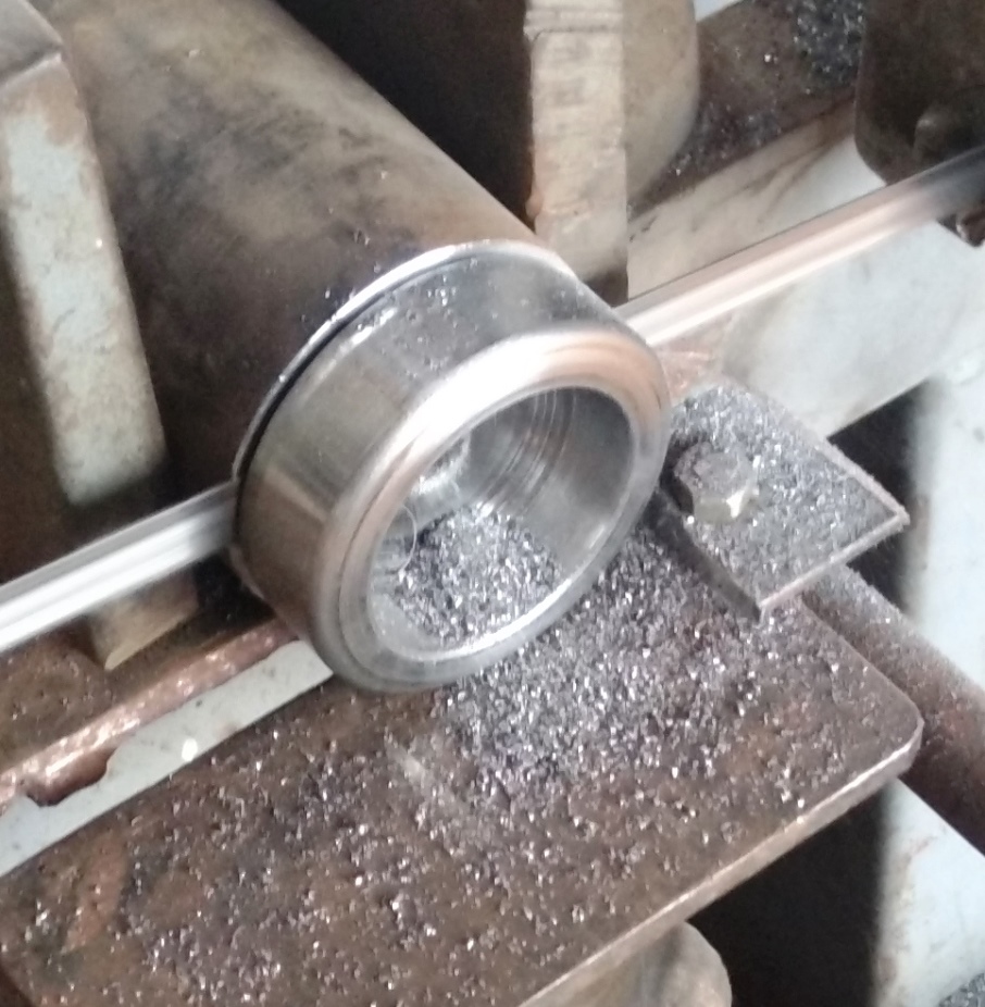

    I started with a piece of mystery shafting I had salvaged a dozen of so of these when I broke up a bunch of Highline stringing reels.
    1 7/8" die stock-img_20211227_102233ds.jpg
    Needs bored just a little deeper
    1 7/8" die stock-img_20211227_110026ds.jpg
    When possible I saw off the parts instead of parting on the lathe this shafting proved to be some pretty tough to machine stuff so why wear out my part off inserts

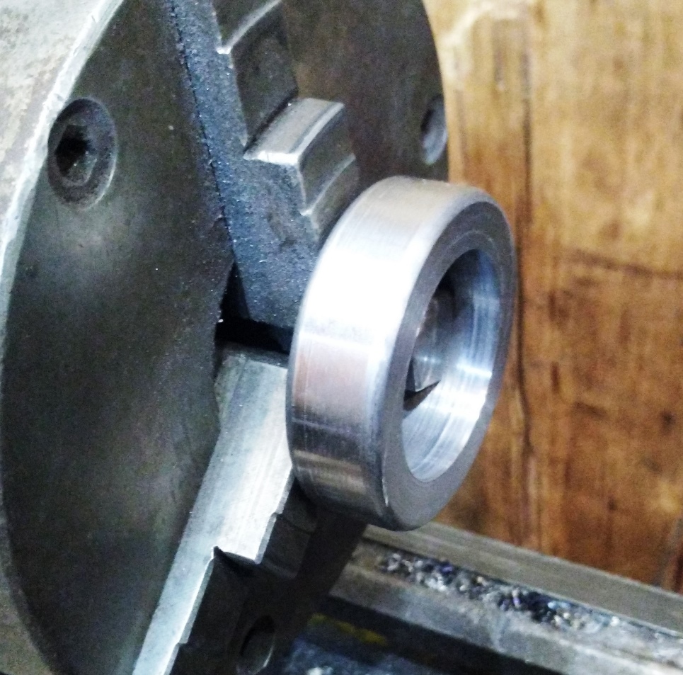

    1 7/8" die stock-img_20211227_111331ds.jpg

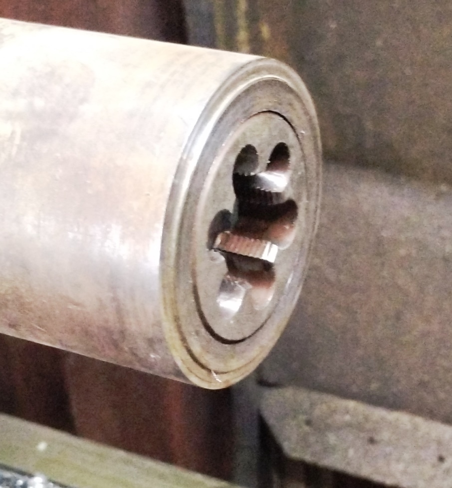

    Chucked in the smaller lathe so I could chuck on the bore
    1 7/8" die stock-img_20211227_111641ds.jpg
    1 7/8" die stock-img_20211227_112701ds.jpg

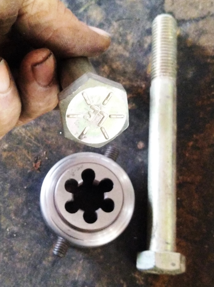

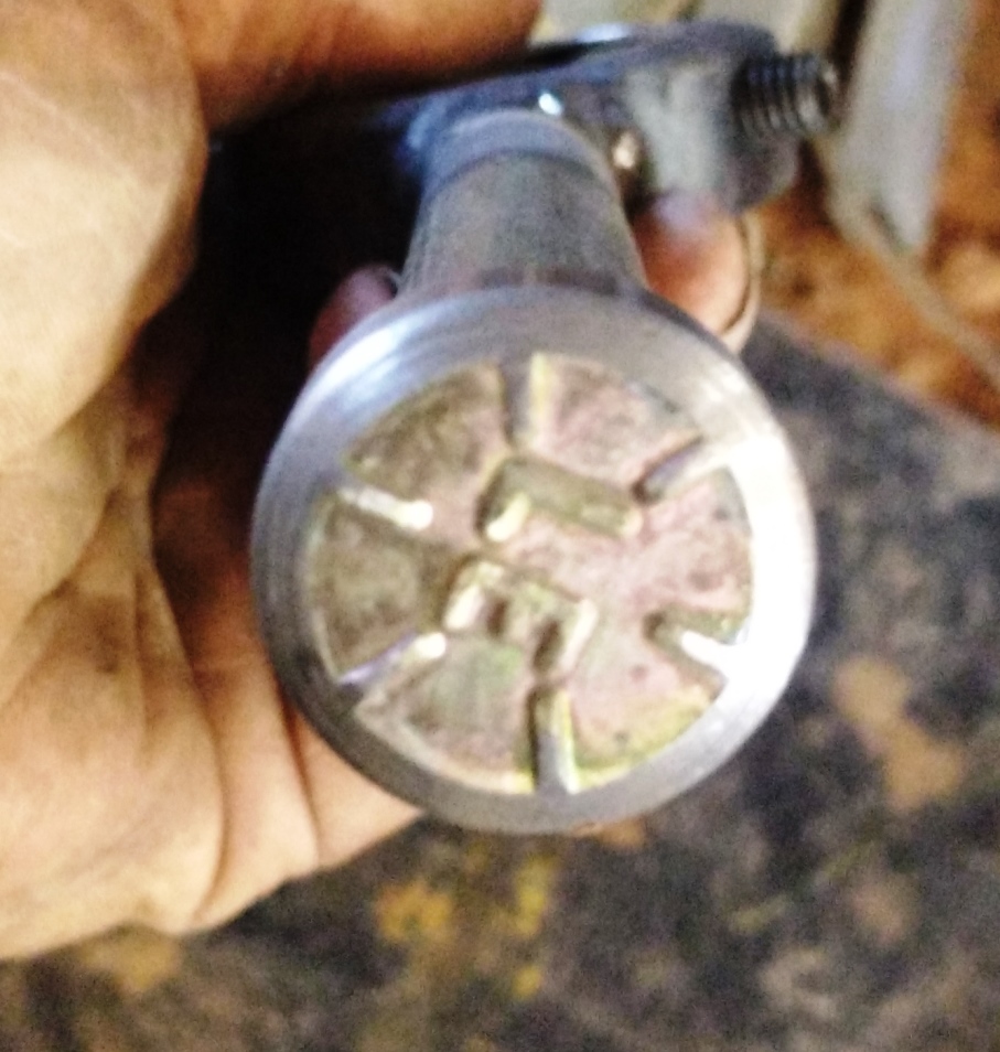

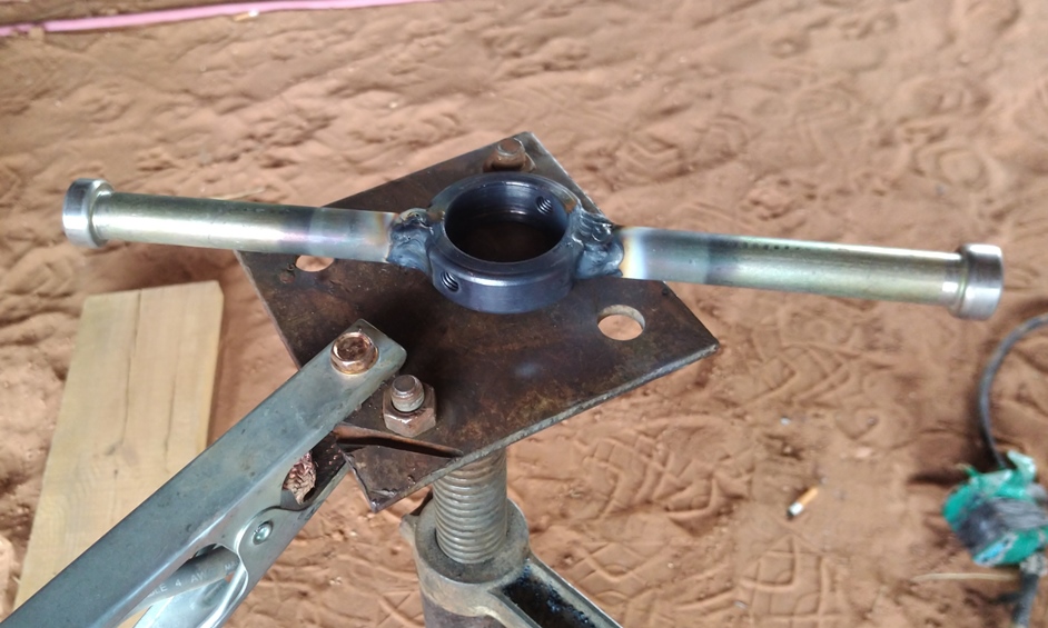

    Next it needs handles these gr8 bolts should do nicely
    1 7/8" die stock-img_20211227_120516ds.jpg
    1 7/8" die stock-img_20211227_124533ds.jpg
    1 7/8" die stock-img_20211227_172503ds.jpg
    I purposely left the gr markings on
    1 7/8" die stock-img_20211227_172515ds.jpg
