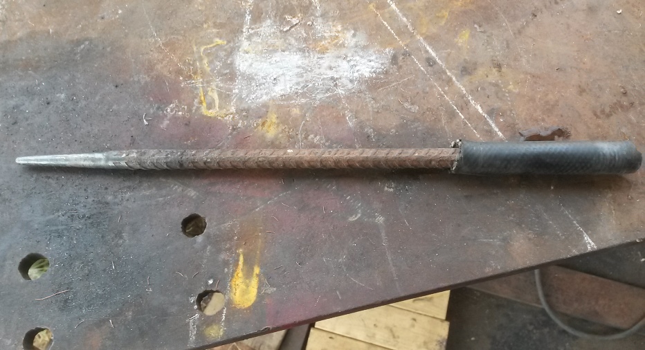

    Beware rebar!!! as tool steel!
    Found another short piece of rebar today this time a 1/2" and 14" long figured it would go well with the previous one which is 3/8" and 9 inches long
    This one I managed to turn the taper on the lathe then heat to cherry and quench it became hard enough to resist a file so I heated to light straw and air cooled it is pretty tough but not brittle Should complement my collection of punches.
    I also have some 3/4" rebar and a piece of 1 1/2" rebar but think I might make other plans of them.
    Attachment 30761
    I used to work in a mini mill and when we rolled rebar, the specs were very forgiving, as a result it was rolled from billets of various grades that did not meet their respective grade for whatever reason. As a result, there was some fine steel going in to the rebar, however some of it was so hard it would actually shatter on the concrete floor when dropped. Bottom line; it could be almost anything depending on where it came from.
    All said, this is a very cool application, and there have been a multitude of rebar projects from all over!

    Rebar and oilfield sucker rod are 2 of my go to items for making things
    While in Kuwait I had my own QA&QC department with testing facilities in the factory that I had built to my specs by our own staff. the Head office was forever getting requests by our much larger competitors to do 3rd party testing since we had a letter of approval as a testing lab from the ministry of building and construction.
    All too frequently my engineers would have to tell those companies engineers that whole batches of sequential lot numbers of materials would have to be rejected. or used only in specific non structurally demanding areas.

    There has been many uses of odd materials and like Frank it is a go to metal and bed frames. Something we are overlooking is the man that did the rifle barrel is in Sweden. There metal might be of better quality than ours. And if he is a gunsmith, he might have done a good heat treat that could have brought the stress factors up. I do not think it would be my choice but interesting the same.

    Quote Originally Posted by ncollar View Post
    bed frames, bed frames , bed frames to use or not to use when to drill and when to give up and use a torch.
    Most newer fed frames are made from hot rolled sheets then sheared and formed
    Pretty easy to spot the ones that may have ball bearings in the steel because at the break in the metal you will spot tiny little stress cracks once in a while.
    It is the older mill formed frames that look like actual angle iron that are the real mystery metals. you might start to drill a hole and not even a cobalt bit can penetrate all the way through but move as little as half an inch and a bargain counter bit that will bend before breaking will drill through like drilling a hole in a tin can.
    Have a band-saw that you don't like the blade that is in it toss an old bed frame in it then try and make the cut all the way through while still having enough teeth on the blade to recognize.
    I've even seen them glaze over a disk in a chop saw.
    As far as the rifle barrel goes due to it being a full bull barrel bored for .22 ammo I wouldn't worry much about that.
