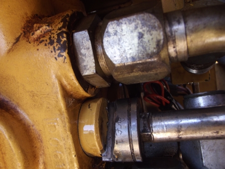

    it worked great in the very confined area. I had to use a hand held impact driver and a 4 lb hammer to break the plug valves loose but about 20 minutes swing the hammer as hard s I could the plugs finally came loose
    1/2" drive large screwdriver-dscf7128c.jpg
    1/2" drive large screwdriver-dscf7129c.jpg
