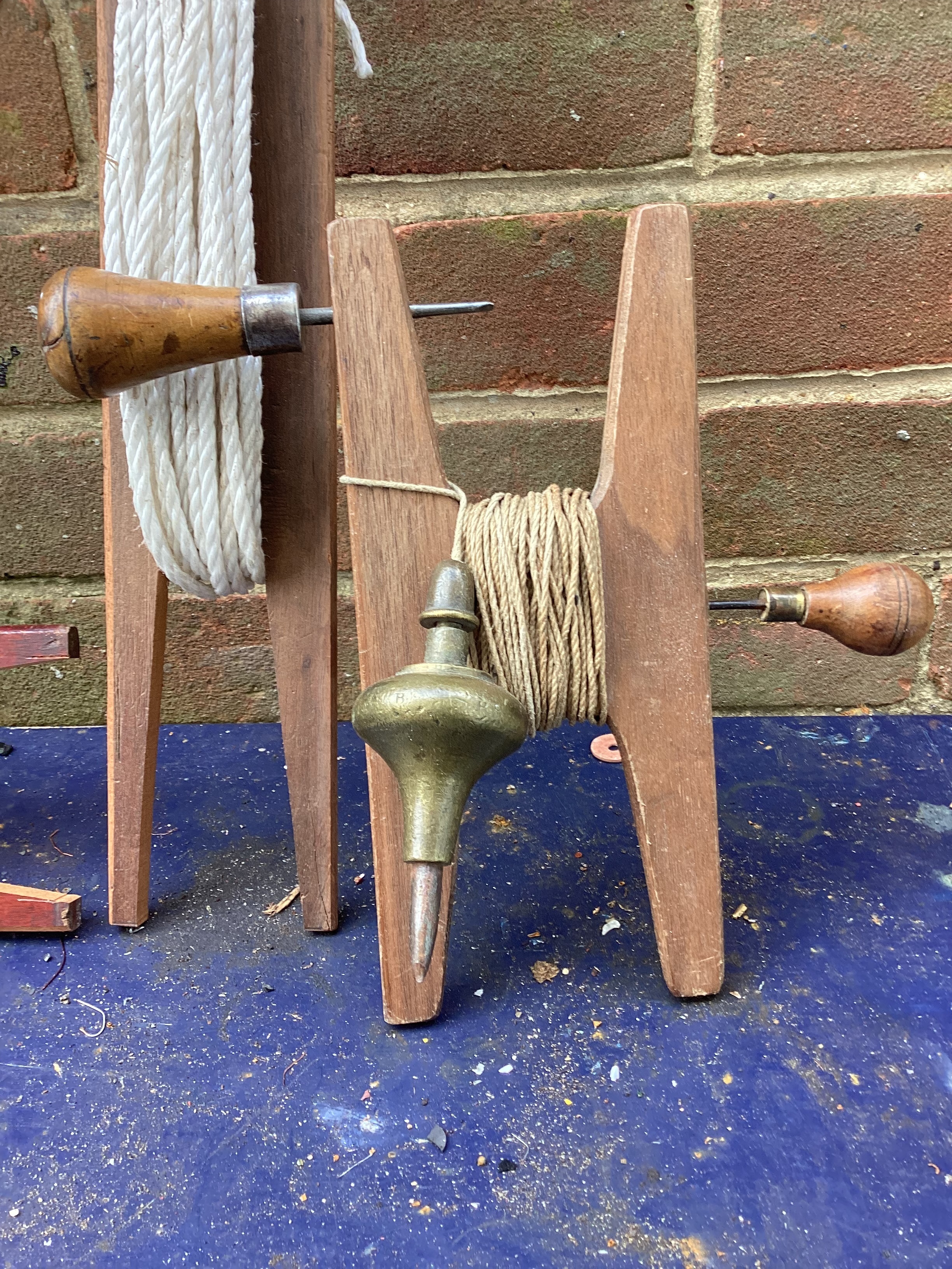

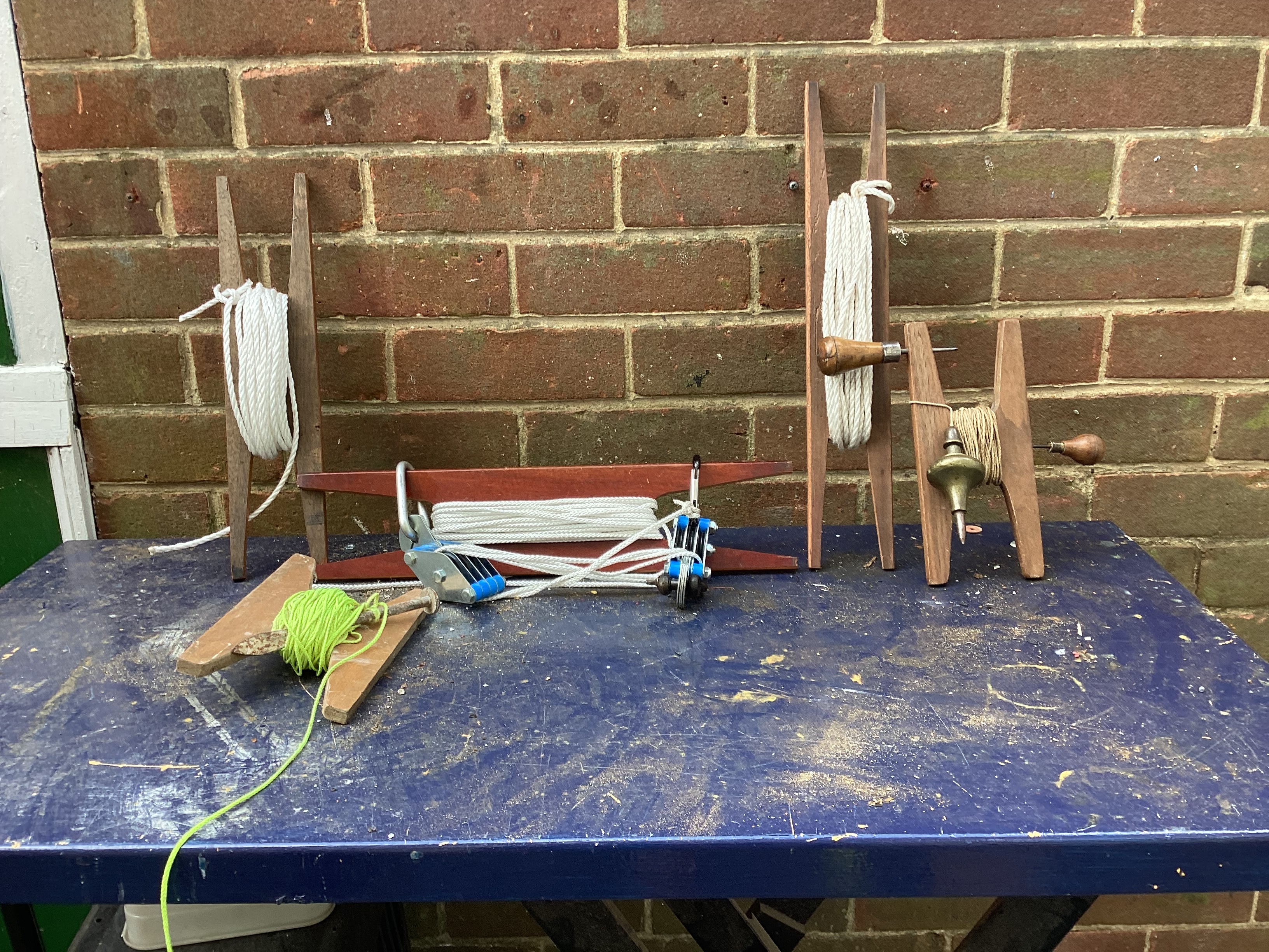

    Maybe this has been put up before, but since I’ve just made three more, this time from bits of mahogany, it’s a pleasure to present the idea again.
    I can’t find the tools I’ve posted previously.
    The second picture shows a deluxe version, which used to be kept in my tool bag, sadly no longer. There are 2 brass ferrules inserted for the bradawls.

    Looking at the pics I'm unable to figure out what the pointy tools in the pictures are all about. I know I'm missing some dark secret here. Like what makes the "butterfly" part of this? EdW

    I would suspect the awls could have a myriad of uses with the butterfly. 1 can be used as the axle while the other the crank to wind up the line with the plumb bob. both could be used as an axle to pay out the line You could stab 1 into a mortar joint or a rafter to hook the line over and the other as a scribe or if a line level is also incorporated stab both of them some distance apart horizontally then use the plumb bob for making a perpendicular line to the horizontal. With a 3rd awl the line plumbbob and a framing square complex geometrical shape can be laid out

    Oh!!. Now I get it. The butterfly is a holder for string or cord that is used for construction measurements. I was thinking of it in the context of something to wrap, carry and store rope, electric cords or similar bulk lines.
    Still, the idea of a wood construction for the storage application has a certain appeal. As I get on in years the aesthtics of the workshop and its contents grows in importance. And construction of simple wood tools and accessories brings a lot of almost instant gratification. To that end I've recently learned how to use a buffing wheel to produce a very pleasant soft finish on wood tool handles. This makes for a pleasant "warm-up" round for a period of shop work. ......... EdW

    Apologies for the lack of clarity. Also, I must acknowledge the author of the idea. It is found in Jeff Taylor’s excellent book, “Tools of the Trade”, sub-titled “ The art and craft of carpentry”. As an illustration of how good the book is, I learned more than 13 things about hammers. Hadn’t known before from just the first chapter.
