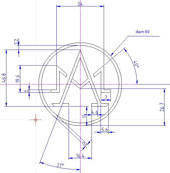

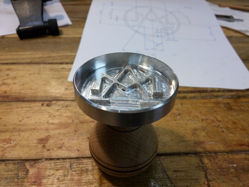

    My son being a passionate pastrycook , I decided to make a cookie stamp for him, with his initials : A M for Antoine Mineau.
    I started by sketching the logo on my CAD software, I used only straight sections

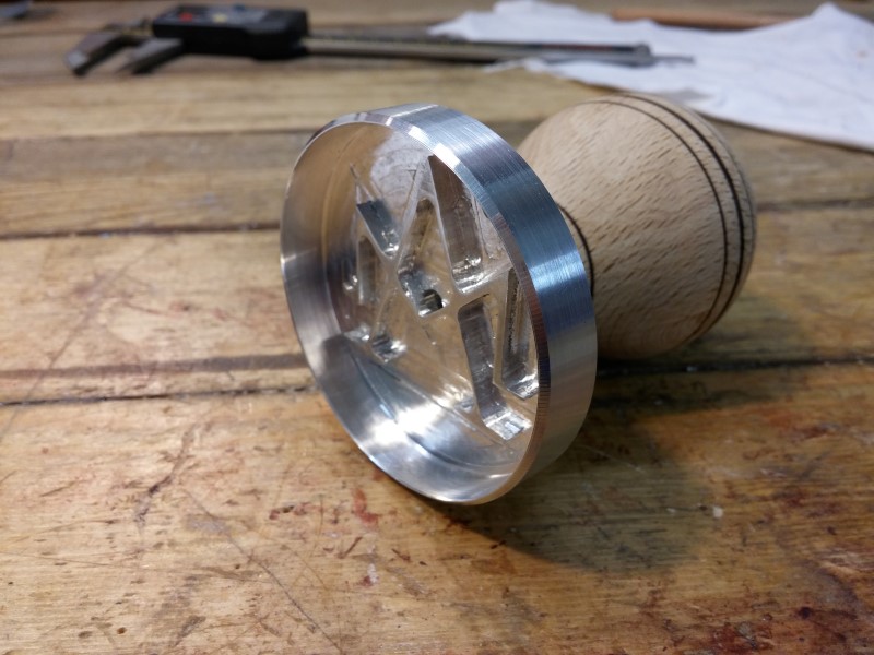

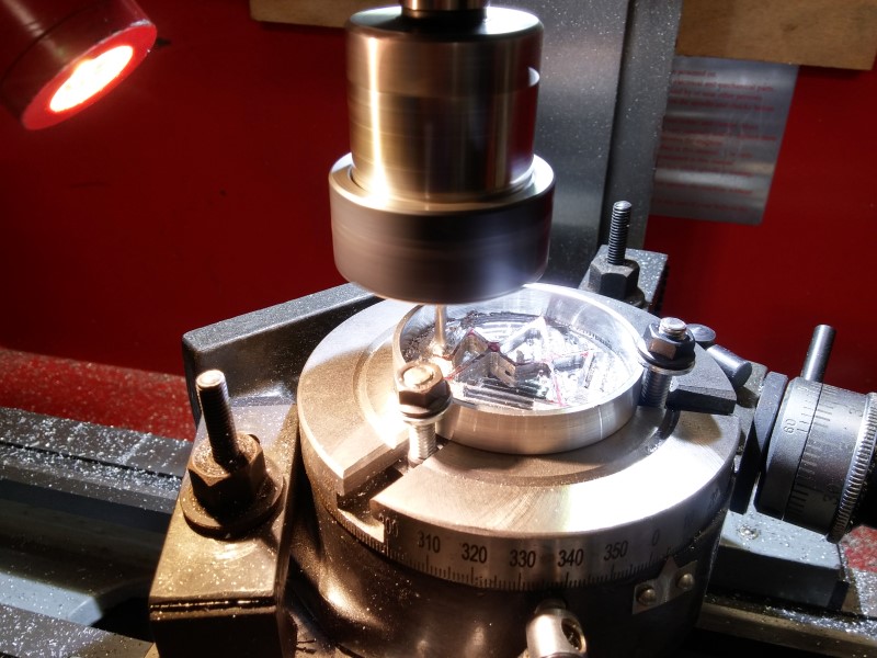

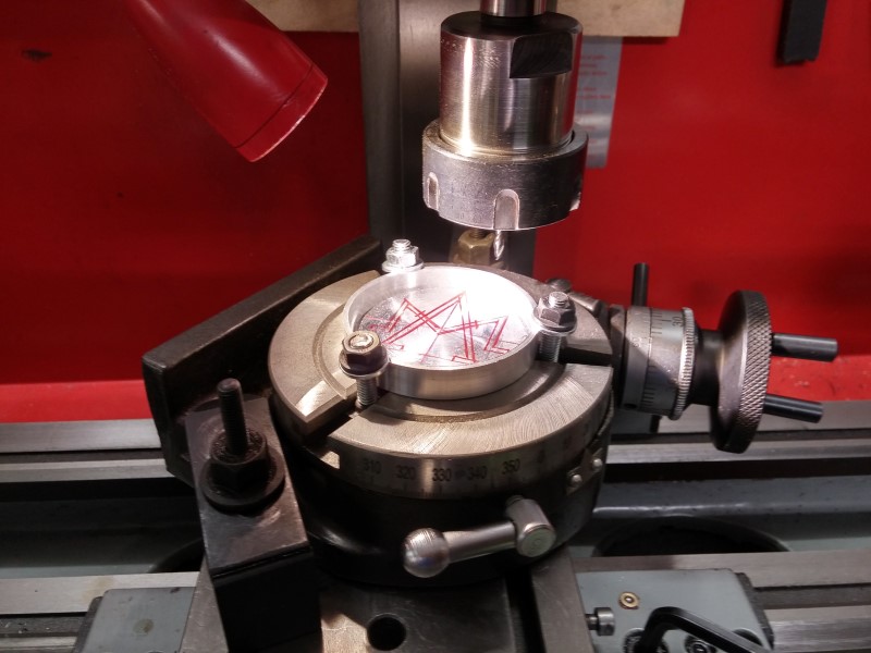

    Then I took a round piece of aluminum stock and first turned the blank, leaving only the relief for be milled:
    It's quite a long process ! ( sooner or later, I'l make a CNC ...)

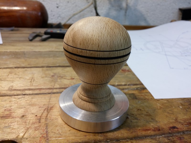

    And then I turned a wooden handle (beech, no finish for cooking tools)
    The handle is hold with a stainless steel screw (I drilled the hole a little too deep)

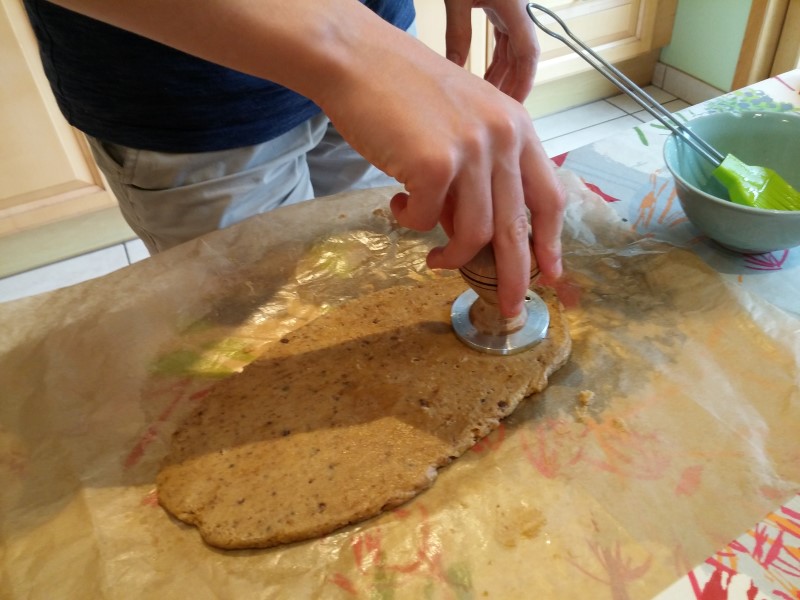

    Rolling the dough. Notice the technic using a couple of 8mm diameter pins in order to set the thickness.

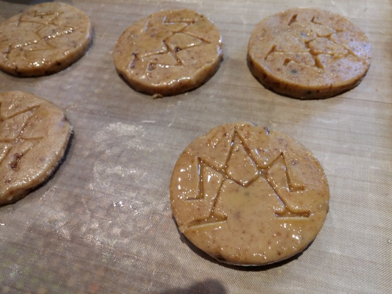

    Stamping (very first attempt)
    A little olive oil in the stamp helps here

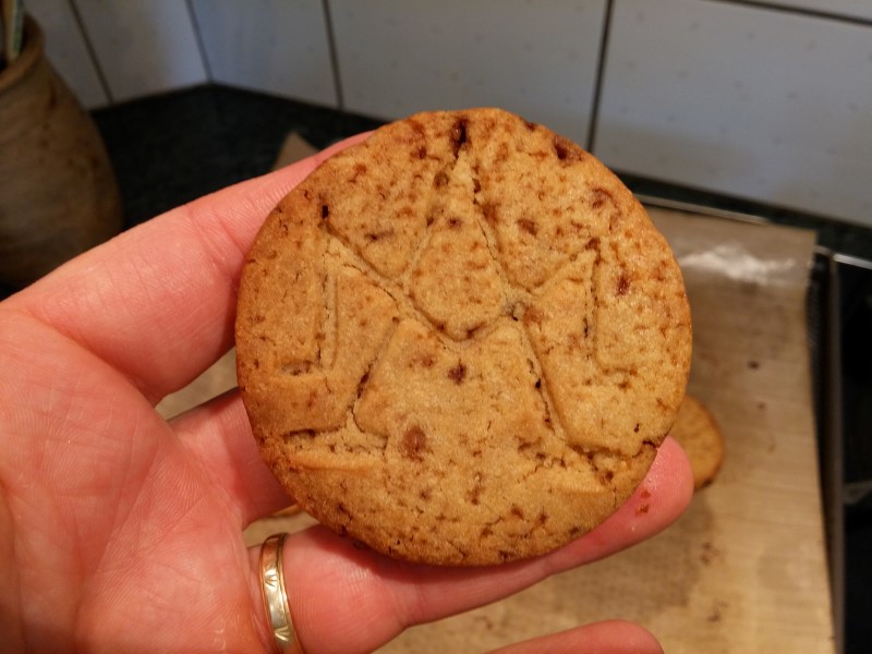

    Baked cookie !

    Thanks everybody for the compliments !
    This run was just a test run, and he used a particularly raw sugar in the receipe (that's what makes the brown points and gives a kind of liquorice taste), but the mark would be more visible I think in a standard receipe.
