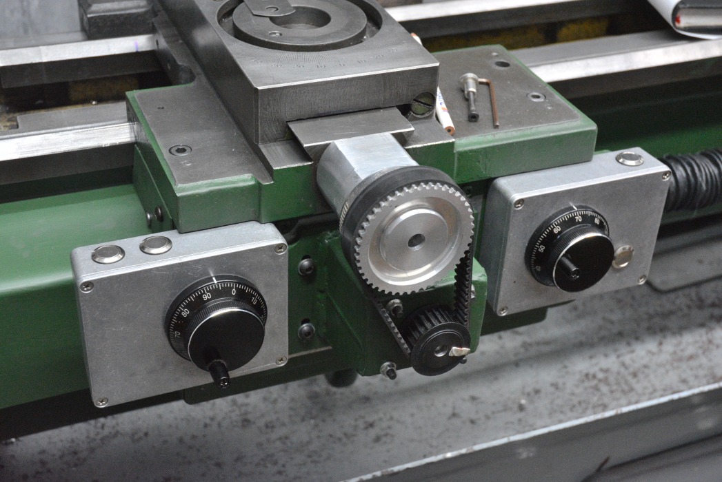

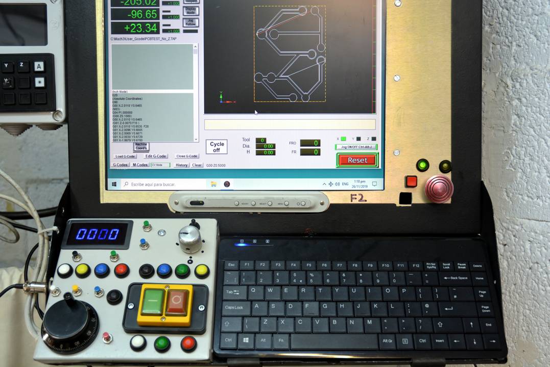

    Quote Originally Posted by nova_robotics View Post
    Can I post Amazon links here? These are the ones I've purchased in the past. They are of excellent quality. The detents feel just as good as the expensive Fanuc factory handwheel that came with my machine. It's a 5v part that provides quadrature output (plus inverted outputs, in case you're machining in a lightning storm).
    https://www.amazon.ca/gp/product/B0875XZS2R
    I use that type on both my mill and lathe. The one on the mill has been in place for many years now without any sign of problems. Cost is around $20 https://www.amazon.es/dp/B08KW77TSM
    A  Manual Pulse Generator for a CNC Controlled Mill-control01.jpg A  Manual Pulse Generator for a CNC Controlled Mill-control02.jpg Click for full size.
    On the mill.
    X and Z on the lathe. Belt and pulleys are normally covered.
