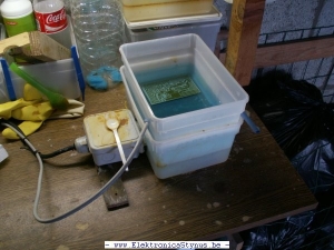

Homemade heated etching tank constructed from surplus washing machine heating elements and ice cream boxes. Equipped with a temperature controller, sensor, and a digital 7-segment display.
