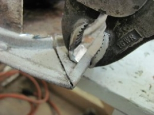

Homemade Door Skin Removal Tool
MP&C on jalopyjournal.com
Homemade door skin removal tool adapted from a surplus pair of Vise-grips. The lower jaw is modified to receive the edge of the door skin, and a chisel blade is welded to the top jaw. The tool can then be used to gently pry up the door skin flange without incurring additional damage.
Sep 11, 2013 4:05 PM
DIYer
Clever mod! I love Vise-Grips!
