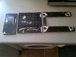

Homemade clamp plate intended to facilitate the process of securely retaining small parts for drilling. Fabricated from 6mm steel plate and incorporating a pattern of tapped M6 holes on 20mm centers.
