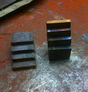

Homemade clamp blocks welded from 5x30mm flat steel stock. Each segment is stepped back 10mm from the one beneath. Capable of being utilized in either orientation.

That's a nifty way of putting a set of stepped clamping blocks together!
