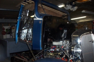

Homemade cab lifter constructed from 2x8 boards. Intended to support the cab beneath the upper portion of the door jamb. Utilizes furring strips to spread the weight. Lifting force is provided by an engine hoist.
