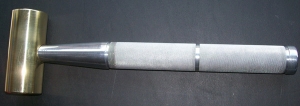

Homemade brass hammer machined from 1 3/4" 360 brass rod and 1 1/2" 6061 aluminum rod. The 4" head weighs 3.3125 lb. and the 14" handle incorporates two knurled areas to facilitate use with one or both hands.
