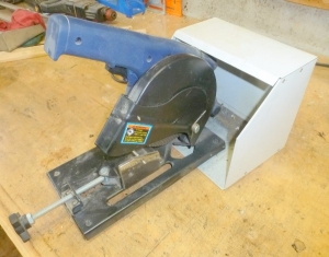

Homemade Bolt Cutting Saw
Stu on bbs.homeshopmachinist.net
Homemade bolt cutting saw adapted from a cutoff saw. Bolts are held by an angle iron bracket drilled and tapped with metric and SAE bolt sizes.
