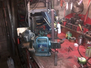

Homemade belt sander adapted from a bench grinder. Pulleys were machined from 25mm round stock. Guard and rest piece were fashioned from a 100x100mm box section offcut, while the upright was 30x5mm flat stock.

A nice add-on for a bench grinder.
