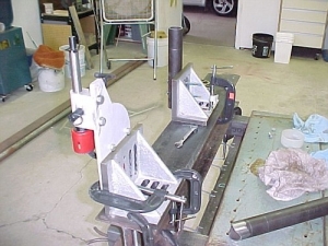

Homemade tube notching fixture consisting of two 90-degree angle plates C-clamped to a jig table. One supports the notcher, while the other utilizes a mounted tubing segment to aid in setting length and orientation for secondary notches.

What a great set-up and explanation. Even I can follow that one. Thanks.
