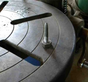

Homemade tang bolt drilling attachment for a drill press table. Table is drilled and tapped to accommodate a stud. Height is set via a lock nut.
