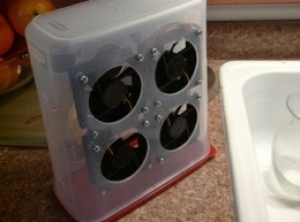

Homemade soldering fume extractor featuring activated carbon filters. Suction provided by four 12-volt PC fans. Filter is sandwiched between two plastic lattices. Components are housed in a plastic container with power supplied by a repurposed laptop PSU through the XLR jack.
