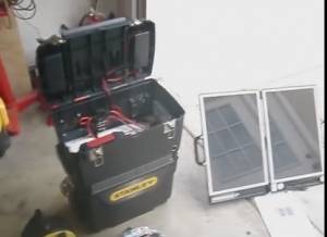

Homemade solar-powered auxiliary power system constructed from a 125AH deep-cycle marine battery, a 10-ampere MPPT charge controller, a 750W inverter, a float charger HF, and a 12v fan, all housed in a plastic portable toolbox. A folding solar panel is utilized to charge the battery.

I like the setup, but would look for a smaller rolling toolbox or case.
