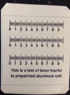

Homemade sheetmetal printing method utilizing a laser printer, a plastic laminator, and a kitchen freezer to transfer toner to a powdercoated metal plate. Design is printed on water-soluble paper before being taped to the plate and repeatedly run through the laminator. Freezer serves to set the toner before removing the paper.
