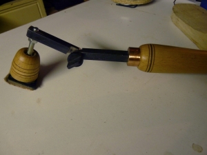

Homemade Sanding Gouge
Homemade sanding gouge constructed from threaded rod, nuts, and a repurposed roller blade ball bearing. Sandpaper is affixed by means of a velcro patch.
