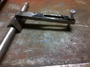

Homemade round stock clamp fabricated from steel plate. One end was drilled and tapped to accommodate the M8 jacking bolt, while a short length of angle iron was welded to the other. Milled slot enables the clamp to be mounted directly to the table.
