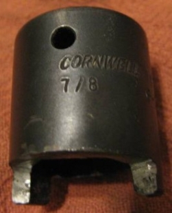

Homemade tool intended to facilitate the process of removing the pre-chamber collars on a Mercedes Type 617 diesel engine. Fashioned by reshaping a 7/8" socket to form tangs corresponding to the grooves of the collars.
