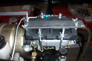

Homemade power bleeder leak fix consisting of a 1/4" x 2" steel plate secured to the master cylinder by means of a chain and eyebolt sling. The plate serves to prevent the master cylinder cover from bowing under pressure and leaking.
