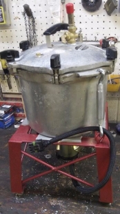

Homemade Open Bowl Centrifuge
rockmike on thedieselstop.com
Homemade open bowl centrifuge intended to facilitate the purification of waste oil. Constructed from steel and a surplus pressure cooker and powered by a 2 HP 5950 RPM motor and equipped with a 1500w heater.
