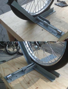

Homemade motorcycle wheel chock fabricated from flat bar and angle iron. Adjustabiity is provided by a threaded rod running through a coupling nut and bearing on the tire. A socket at the opposite end of the threaded rod permits faster tightening of the chock.
