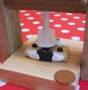

Homemade magnetic sensor test rig fashioned from wood and utilizing plastic toilet fittings to minimize field interference. Magnet and PCB are secured with Sugru. Powered by a 5v supply via an I2C bus.
