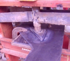

Homemade forming die and punch intended for utilization in conjunction with a shop press. Powered by a pneumatic over hydraulic 12-ton jack. Capable of forming dimples in 3/16" steel plate.
