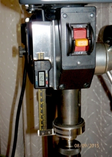

Homemade drill press DRO comprised of a digital caliper mounted to the quill by means of an aluminum bracket and a hose clamp.
