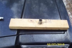

Homemade door lift jack attachment designed to facilitate lifting and securing a car door during adjustment of its hinge bolts. Fabricated from a section of 2x4. Incorporates a dado (to provide an area in which to rest the door edge) and a short piece of electrical conduit to function as an interface with the floor jack.

Simple, Quick, Easy & it worked.
