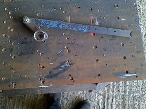

Homemade crankshaft nut tool constructed from 1/4" x 1" and 1/4" flat bar stock. Incorporates a 1/2" socket welded to the short, pivoting segment. Intended to be struck by a hammer as a means of freeing stuck crank nuts.
