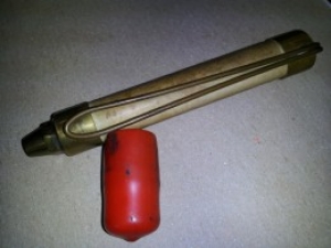

Flashlight made out of an industrial fuse. The fuse is drilled to fit AA batteries and a brass flare fitting holds the bulb. The switch is a brazing rod soldered on one end which also serves as a clip when the light is not in use.

Aptly named. I'll have to come back and study this some more.
