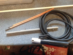

Homemade carbon arc torch constructed from a spot welding attachment, a length of steel tubing, and an electrode clamp. Rods are secured in position with a 3mm set screw.
