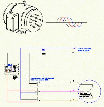

    Supporting Member smithdoor's Avatar
    Clovis CA
    59
    Thanked 16 Times in 9 Posts
    Are you working with 208 or is the machine tool 208
    If you have in shop 208 that is three phase at you door step
    Dave

    Quote Originally Posted by smithdoor View Post
    Dave
    Just wondering what bearing your post, Dave, has to do with Mr. Lintelle's inquiry about horsepower.
  6. #36
    Clovis CA
    59
    The question is (If you have three why would you need converter?)
    To me it simple just change a meter ring to 4 pole and skip the converter Their may be some else that I do not know at this time
    Dave
