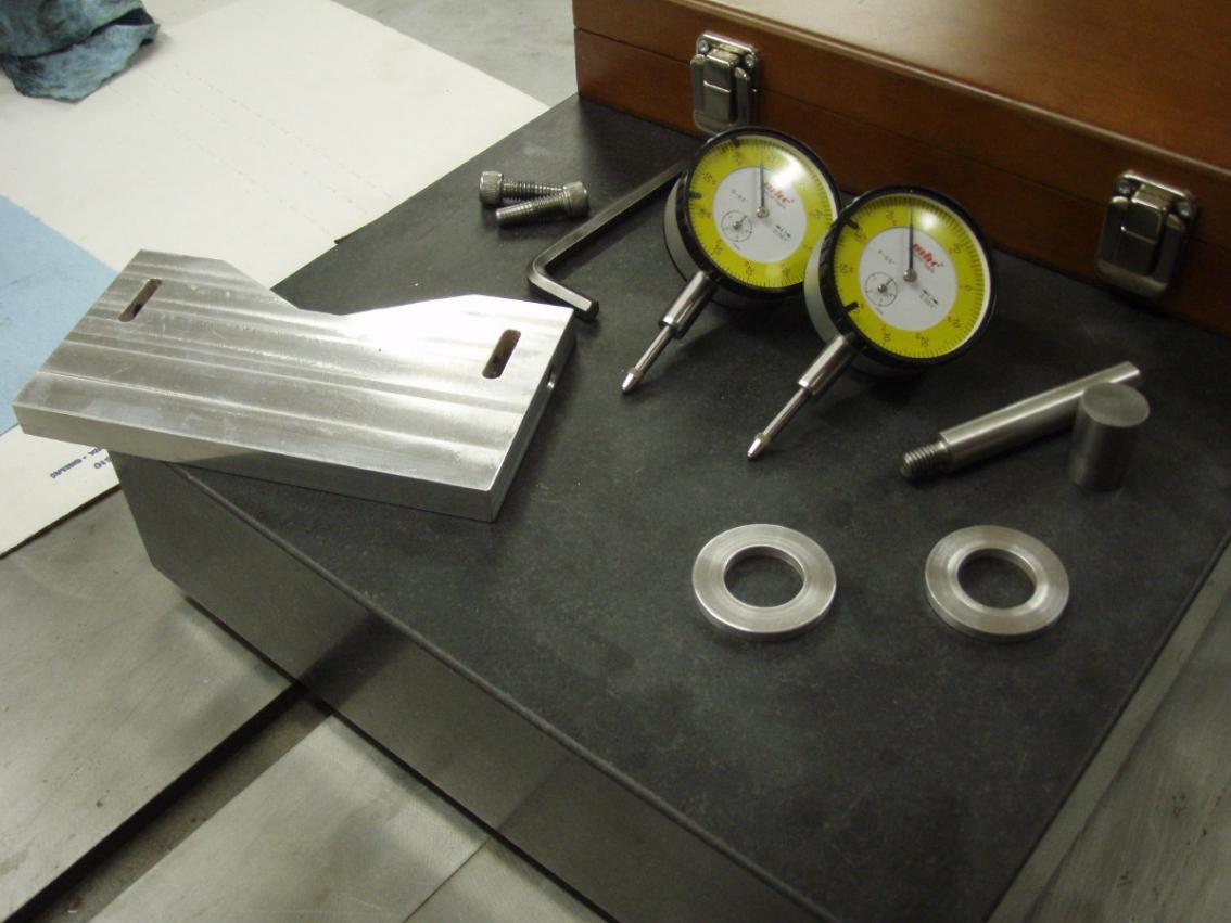

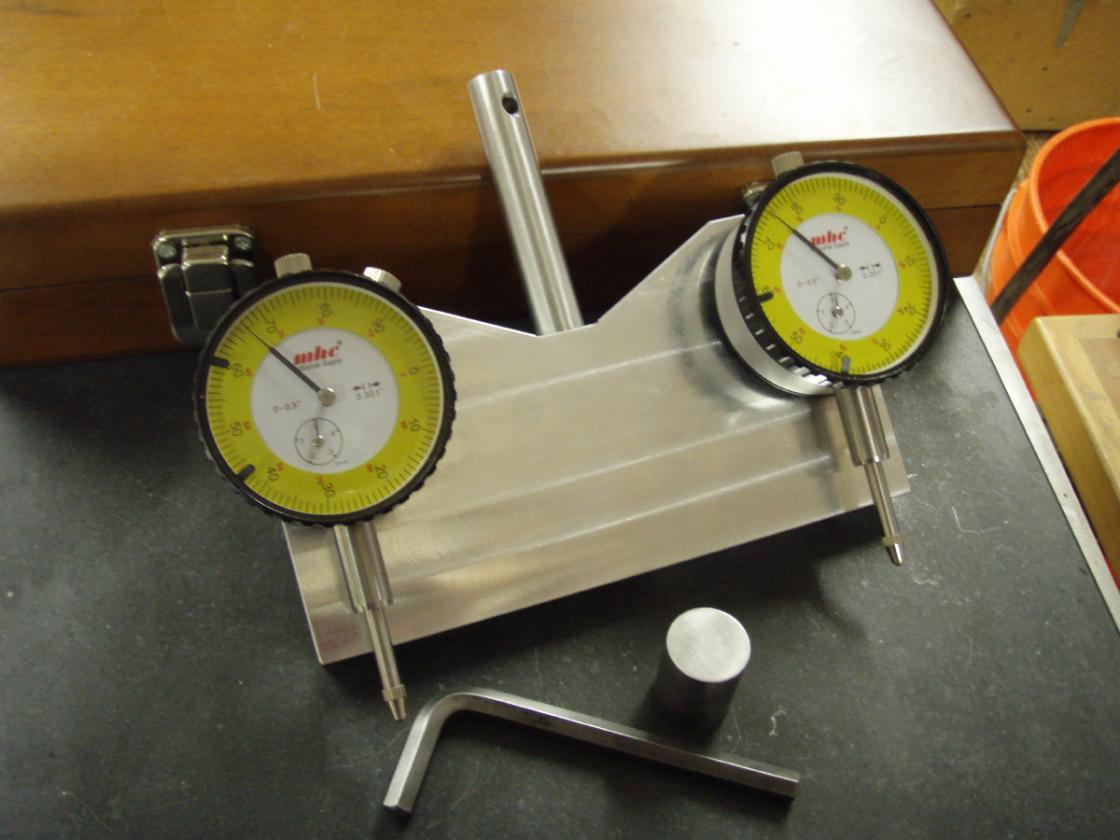

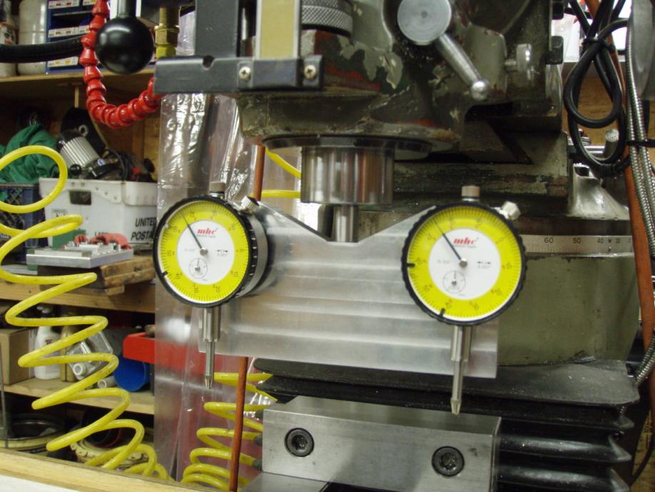

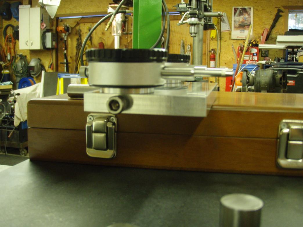

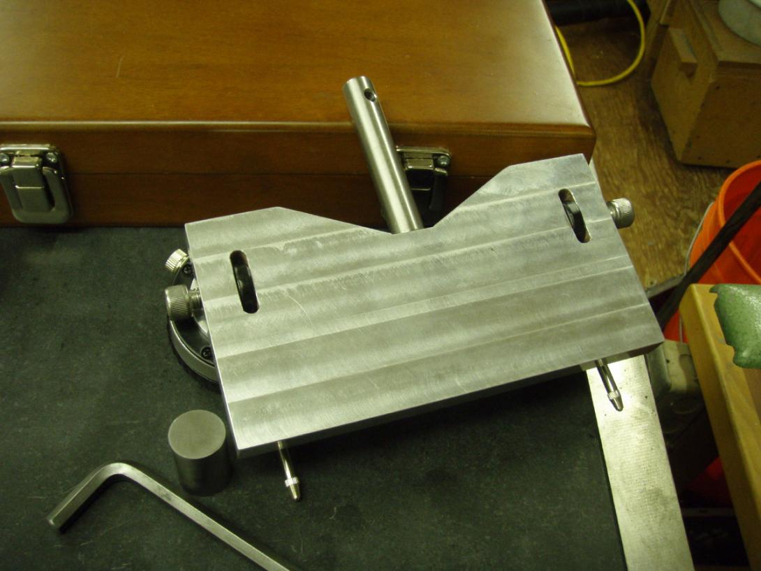

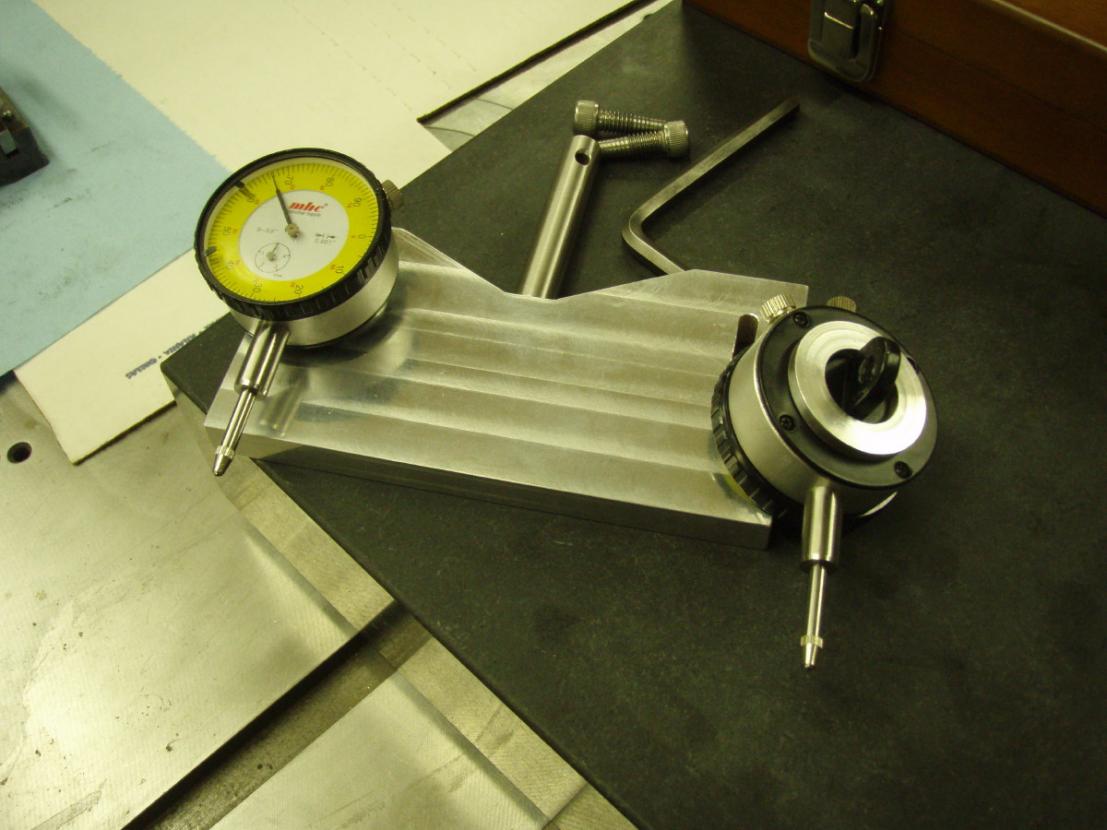

    A new Tram gauge for my son for Christmas. 1/2" x 3" Stainless mounting rod - turned with a 5/16"-18 mounting tread, 6061 Alu. 1/2" thick plate - Slots milled for the back lug, 2 Dial gauges with 1/4" back lugs, 2 ea 5/16"-18 Stainless Socket Head screws - these I turned with a taper to pass thru the back lug and pull the gauge tight against the plate, 2 ea. 1-1/2" dia. 6061 Alu washers 0.160" thick - these made for the gap between the gauge and the plate and made to fit over the back lug, 1 ea. 3/4" dia x 1" Steel Calibration rod.
