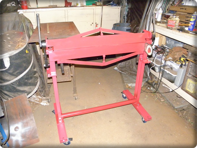

    Harbor Freight 36 inch sheet metal brake. Installed 2 inch metal tube at base of unit, new wheels removed unneeded weld that makes it a real 36 inch brake. I have a hold down that is attached to a cement lug in the shop so that the brake won't move when bending.

    Thanks for the response. Seeing the work you do is good reinforcement. I am wondering at what you call a 'cement lug'.
    Mods accomplish a few goals. One is to practice reverse engineering. Especially figuring work-arounds of sloppy tolerances. Two of course, needing element(s) beyond our current equipment. Three goes back to the HFT thread and Craigslist, or garage sales to get a basis for project so & so. And then, like you know who signs "Never tell me it can't be done".
    Right now I'm building an "open" brake. The apron and leaf are vertical. Commercial versions [about $350] have a 2" width and back gauge too short and my project needs 3" and 27" long. All I started with is the same photo all the sellers have, that I scaled up Fibonacci style.

    I drilled a hole in the cement floor and put a cement anchor in it to use with a bracket that goes around the metal tube at the bottom to hold down the brake.
