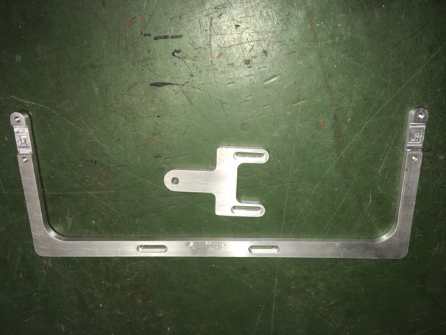

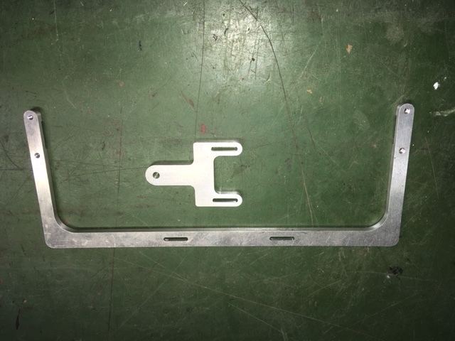

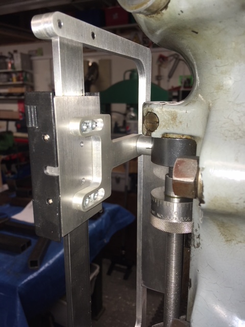

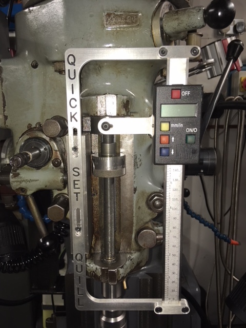

    Hi All
    I made this simple bracket to fit my Bridgeport Mill Quill. This is a very useful and quick setting tool. Yes, you can buy a commercially made one but at £200 plus they are not cheap. So, I decided to make one. The digital readout itself was an eBay buy at £34 and the aluminium was just some off cuts from another project. I also had to buy some longer UNC screw to attach the bracket to the mill. In total about £50 all in. (not taking in consideration my time, which I consider to be free as this is one of my hobbies) I did engrave the text on the bracket on a friends machine.
    I am also going to fit one, to the lathe tailstock in the near future just need to decide how I want to mount it.

    Many thanks again for taking the time to view.
    The Home Engineer

    Thanks for the ideas bud, gives me something to think about for my quill DRO project. AND it looks nice!
    Mark
