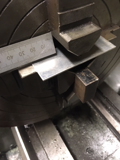

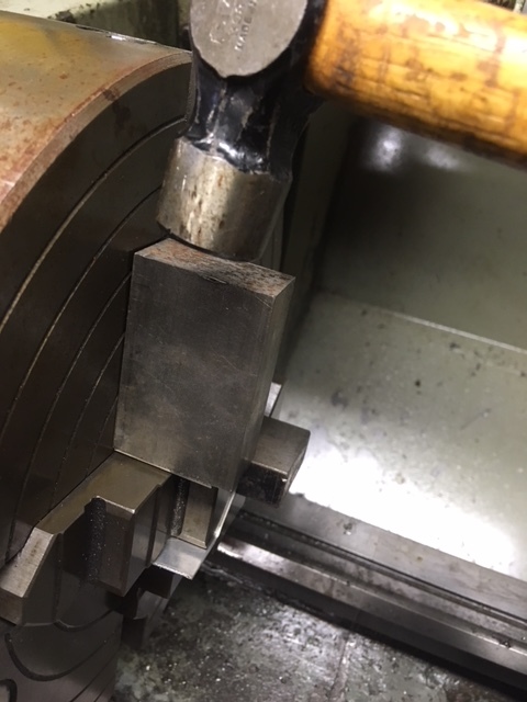

    Hi All
    I made some soft jaws today out of some aluminium sheet. The photos below show the method I used. What I hate about setting a four-jaw chuck is the damage the hard jaws can do to the component. Also when using packing between the job and jaws this tends to fall out when adjusting the job to run concentric.
    These soft jaws only took ten minutes to make (please no comments like “it looks like it” lol) It took me longer to find the material than to make them and to write this post.

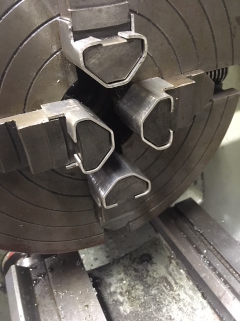

    As you can see these are retained around the jaws so no more frustrating time looking for packing in the bottom of the swarf tray.

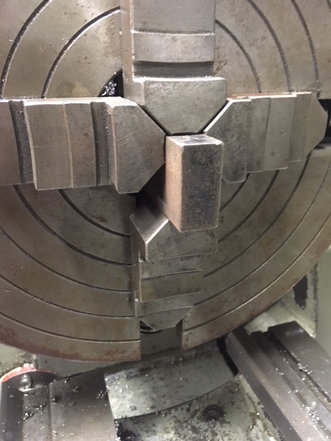

    Setting the four-jaw chuck up to use as a press tool the piece of stock is there purely to flatten the bottom of the soft jaw

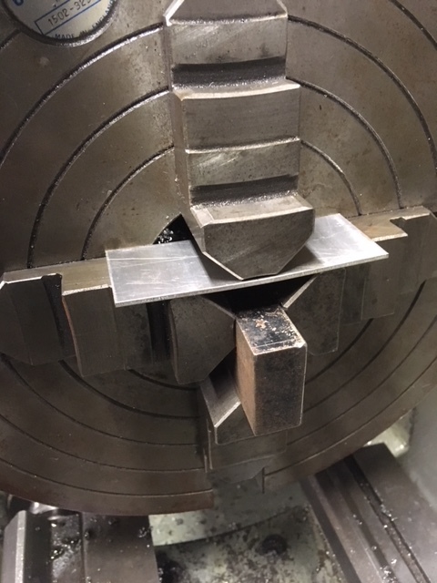

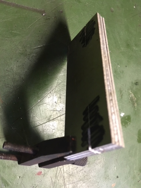

    Gang cutting all four pieces of aluminium, the slit will form the locking tabs

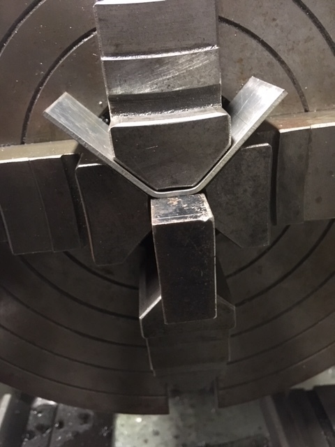

    Setting the aluminium central to the jaw to ensure they bend evenly
    Pressing the sheet with the chuck jaw down tightly on to the stock

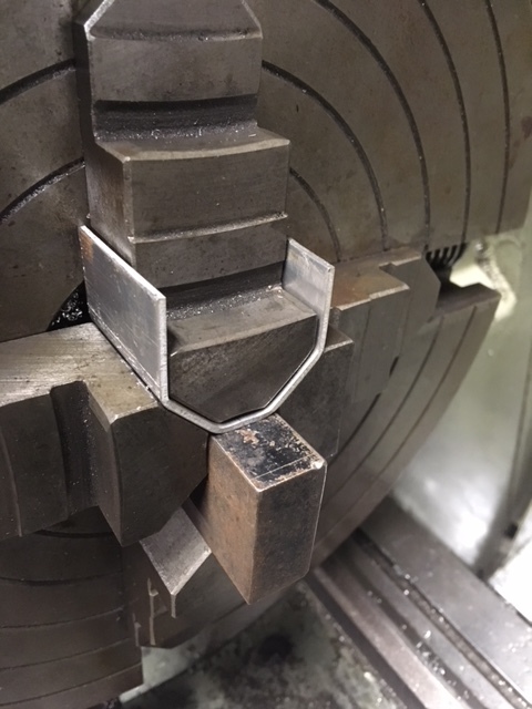

    Knocking the sheet to fit tightly to the Jaws.

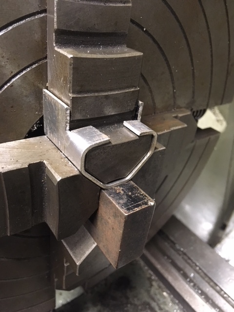

    Bending the locking tabs down

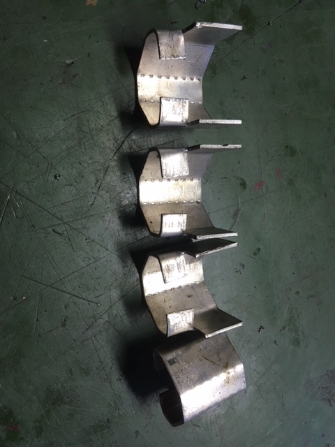

    Finished soft jaws.
    Aluminium soft jaws for the four-jaw chuck-img_0622.jpgAluminium soft jaws for the four-jaw chuck-img_0623.jpg
    Hope this will make your life easier when you don’t want horrible jaw marks all over your work piece

    What type of aluminum did you use. It seems every time I try something like this I get stress cracks. I can never remember which type is malleable.
  16. #9
    Nov 2017
    Berkshire UK
    742
    751
    Thanked 2,203 Times in 431 Posts
    thehomeengineer's Tools
    Fully annealed aluminium. If the aluminium is hard run hand soap over the material and heat until the soap goes black and this will be the temperature for annealing aluminium and allow to cool naturally. The hard aluminium will be soft and workable. This is the method I use and it works but I am sure there are other methods for annealing aluminium.
